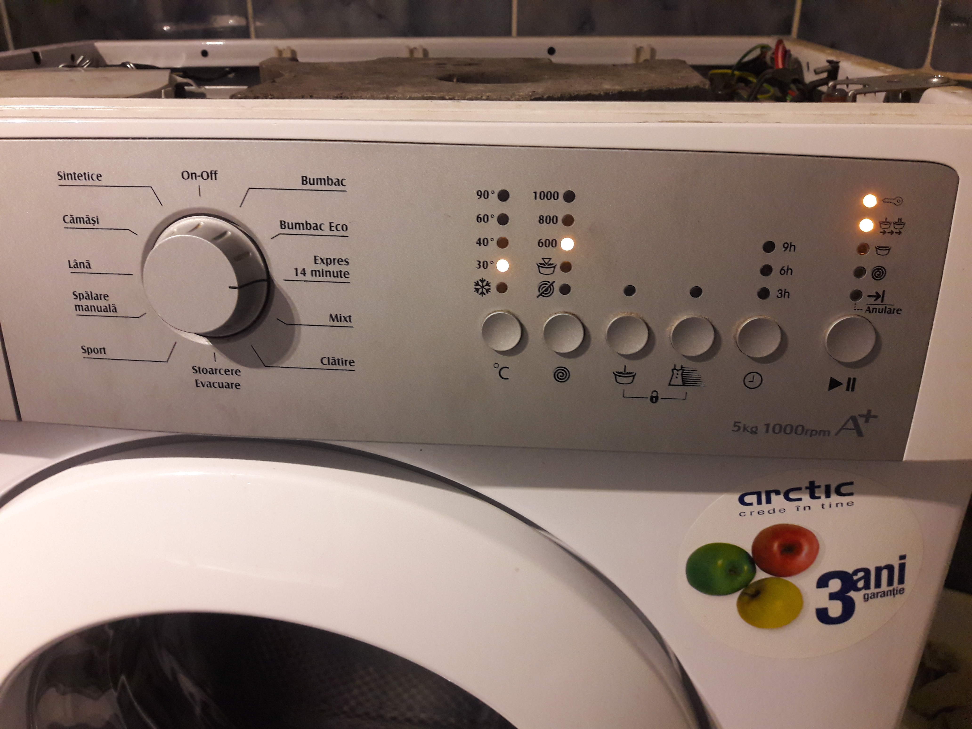

A few days ago I used the washing machine, it worked for a minute and then there was a noise, (like a short circuit), and a heavy smell, the washing machine stopped and has not worked since then. The door of the washing machine closes and I can select the programs but when I press the start button it gets stuck. No water no spin just a noise at door when i press start button. help please arctic al1000a+

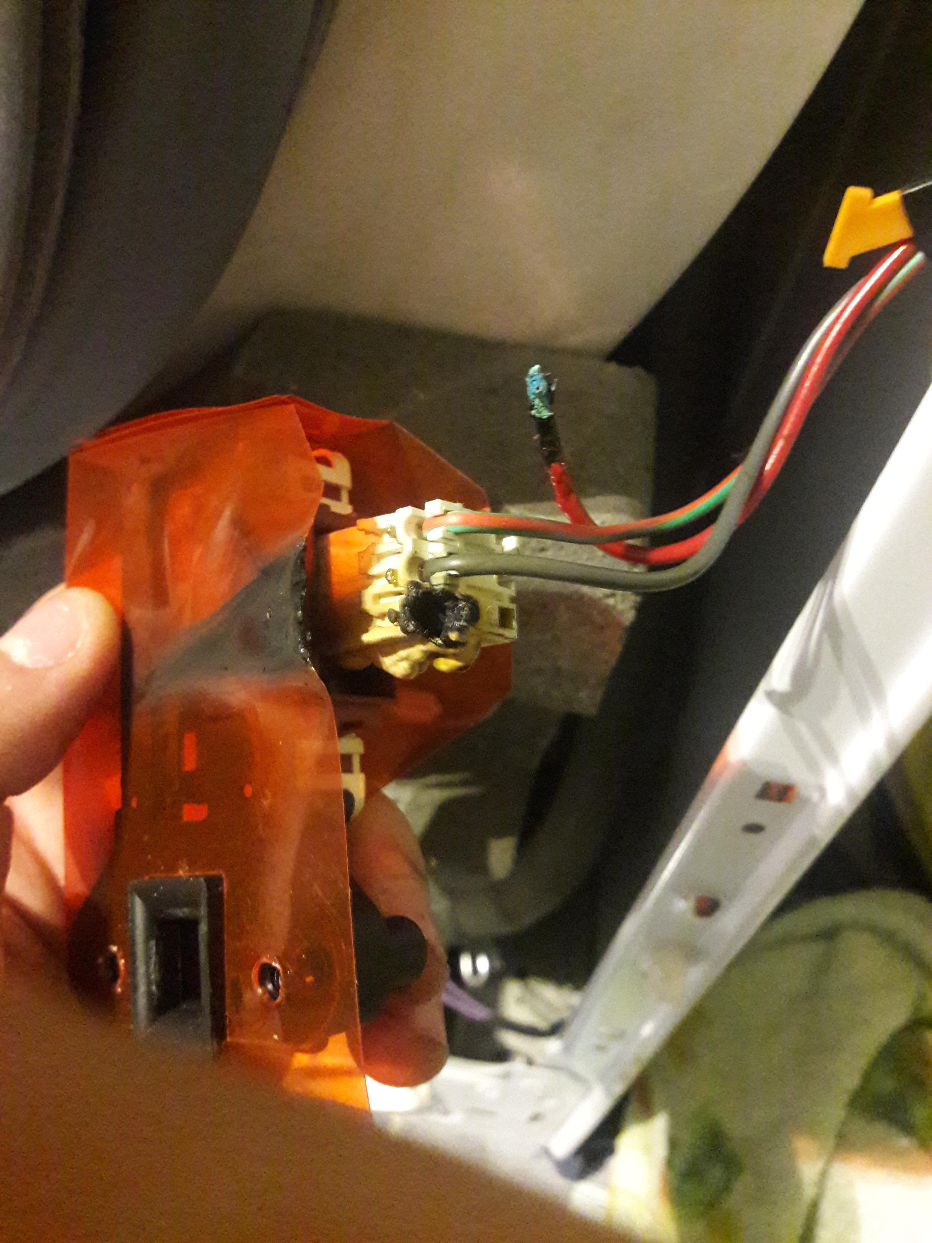

I took off the mask in front of the washing machine and found something like this at the closing system. Could this be the problem? when I started the washing machine, the door closes

Definitely. It would need a new door lock, a new white connector, and all the hard and burned parts of the wires would need cutting away. Hopefully the wires could be pulled through and lengthened, so they can still reach afterwards. This is something that just shouldn't happen, and I've seen reports in the past where they issued a safety notice about this exact same thing - "risk of causing fires".
BTW I've never seen a washing machine like that (the control panel) but it looks like a Hotpoint inside.
It's dangerous like that because it bypasses the door lock. The door can be opened at any point during wash and spin.
