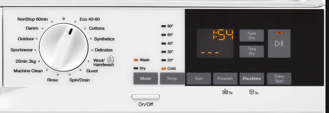

I have a washer dryer which is just outside the warranty period and has failed again with the same fault with the dryer in this washer\dryer model.
Anytime the programme is set to use the dryer (say for 60 mins of drying for a few towels), it starts and runs the clock down a few mins of I guess draining the drum and then timer jumps straight down to like 5 mins, never heating the drum or running the heating cycle and seems to be entering the closing sequence of the programme.  There are no errors displayed on the LCD display relating to the programme operation.
I would like to see if there are any error codes stored in the system, but don't know which button\sequence to press to get in and read the codes, if anyone can assist me with this particular model?
The display controls are shown below from a screenshot from the internet

Hi there. I would think it is unlikely for error codes to be logged, and accessible with specific button sequences but not shown to the user. Of course, it's possible that some manufacturers might have decided to deliberately hide error codes from users. Generally though if a washing machine detects an error it will display it so that it can be looked up in the instruction manual or reported to the engineer when booking a visit.
You say that this is the 2nd time this happened, can you remember what the cause of it was before? That may be a silly question as presumably if you could you wouldn't be posting here?
It's unusual for it to do this but maybe it is overheating and aborting? I would take off the lid and put it on a drying cycle and then make sure that the dryer fan is running.

When the engineer visited previously to resolve the failure 1st time, he confirmed the failure by showing me a stored fault information(not a user displayed) by pressing some keystrokes on the button panel, so there was definitely some additional information which he was able to retrieve by going into engineer\diagnostic\test mode. Once he replaced the faulty part he then cleared the code and checked it did not re-appear after a test drying cycle.  I would like to understand how to access this engineer\diagnostic\test mode to see if the code is still stored in the electronics.

Can you advise me how to get into the engineer\diagnostic\test mode ?
Sorry no. I have a lot of error code explanations but not the manufacturer retrieval sequences.
