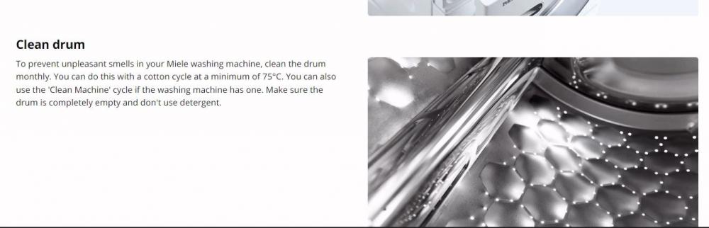

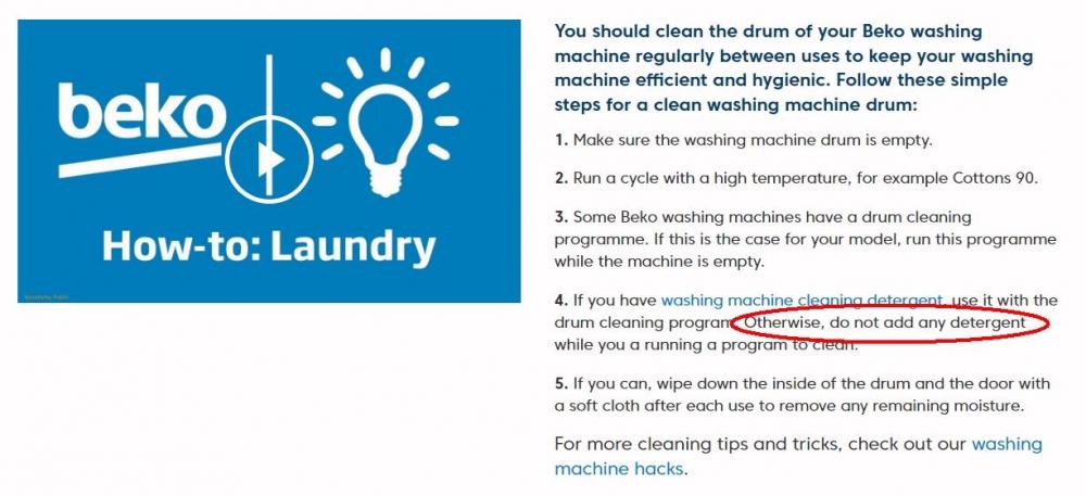

I dont think you should be using detergent in the drum cleaning cycle Andy (I know, i'm like teaching you grandmother to suck eggs LOL)
but here are instructions for drum cleaning from Miele machines (you have a Miele machine yourself?)  - use no detergent :
and Instructions for Beko machines - use no detergents:
