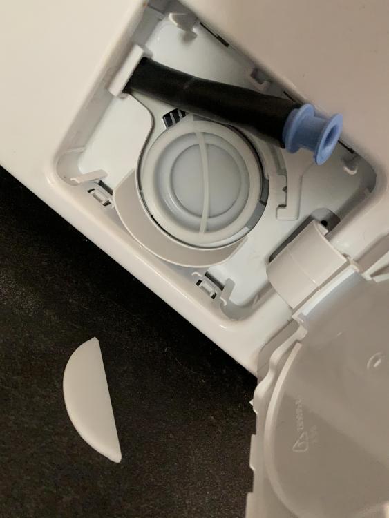

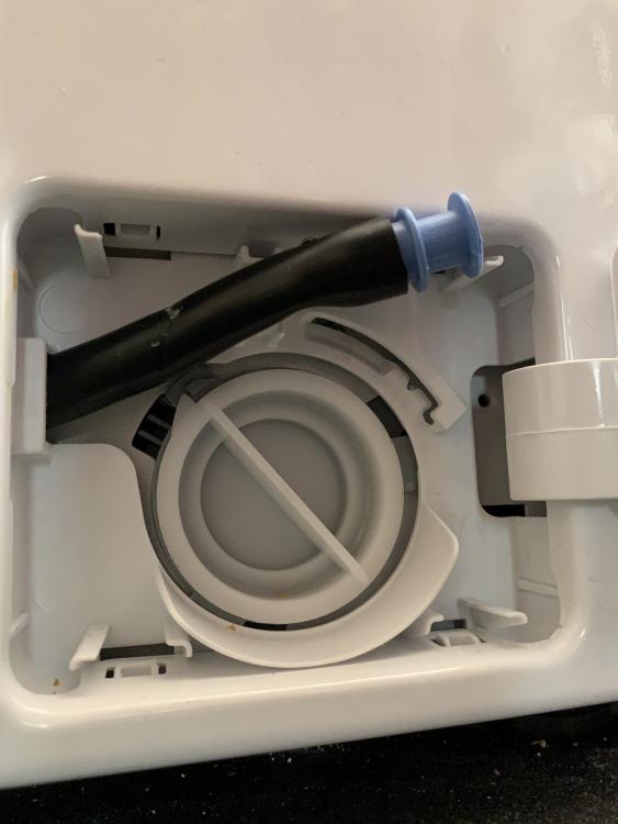

Can someone please tell me what I’m missing that I can’t open this thing? I believe I’m supposed to turn it anti clockwise but it will not budge. Is there something else that needs to be done first? It can’t be this difficult

No it won’t turn clockwise either. Why is it on so tight? Does something have to be dislodged first? It’s unlikely anything is jamming it because I always empty my pockets - I’m just wondering if there’s some paper in there because I recently forgot to take a tag off a new tshirt and this morning I noticed some water in the drum after I had taken the clean laundry out. I’ve already drained the water from the tube. This is also the first time I’ve ever done this. How could it be if I can’t get that open?

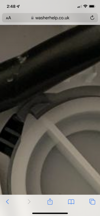

Btw does that plastic part that the jagged edge of the pump filter rests up against at top left move or press down at all?

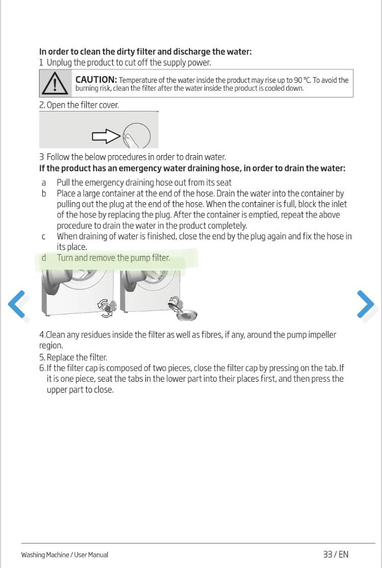

And finally have you looked in the instruction manual? It will tell you exactly how to take it off.

- and that grey part doesn’t seem to move

The manual just says “Turn and remove the pump filter”
Just looking at the last instructions in the manual page you posted. (No 6). Not sure what it’s on about, does the part that you turn to try to open it pull or push in?

This shows it's clearly rock solid. It's hard to think of anything that could make it so solidly jammed it won't even move a mm. It's almost as if it's a dummy and not meant to come off at all, but that looks exactly like a normal pump filter and if it says it comes off in the instruction manual it should.
The only way to get to it is as I mentioned before and make sure it’s drained of as much water as possible and completely disconnected from the electric supply. Then lay it down to take off the sump hose, and maybe even the pump itself gaining access from underneath.
