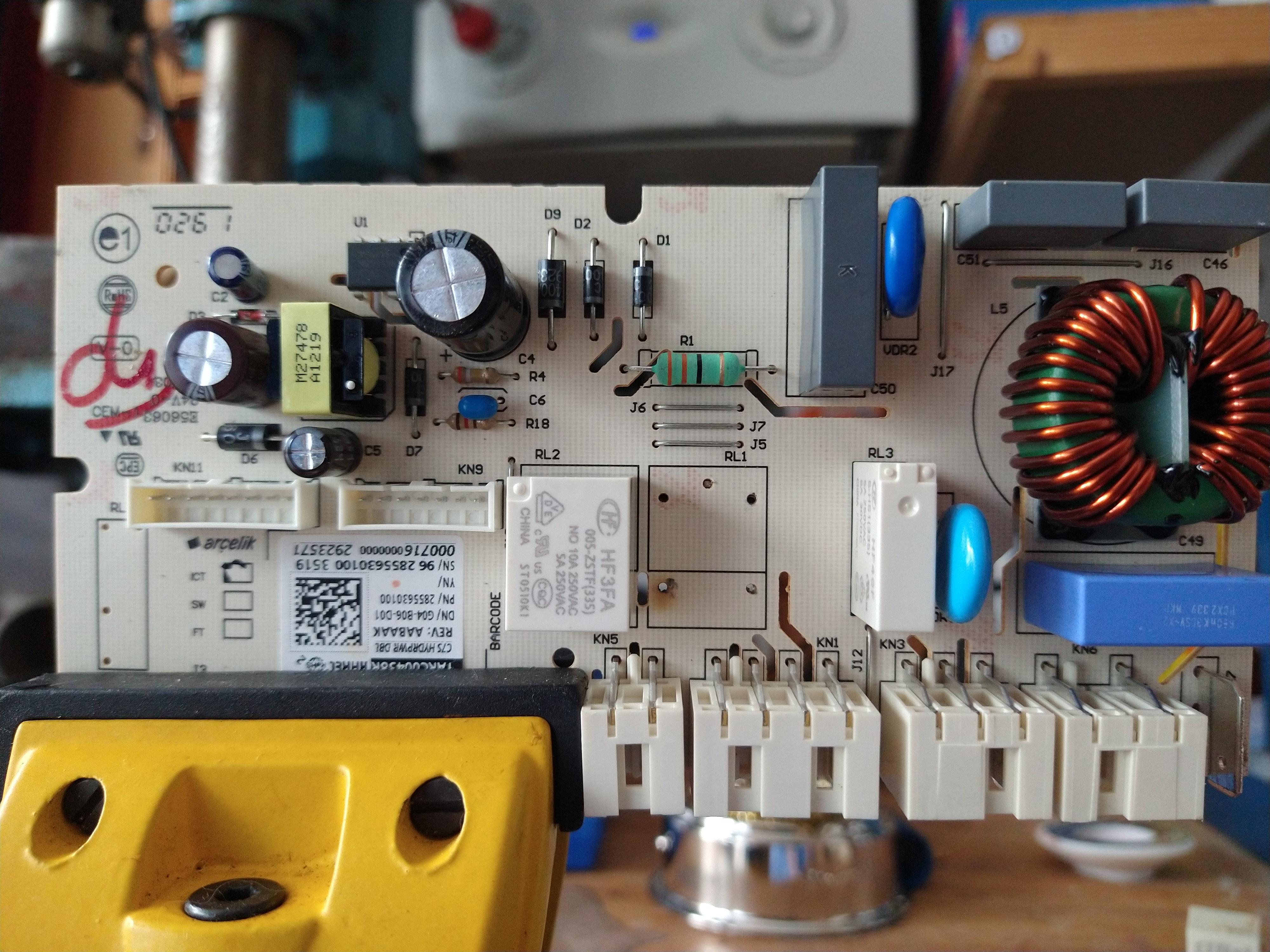

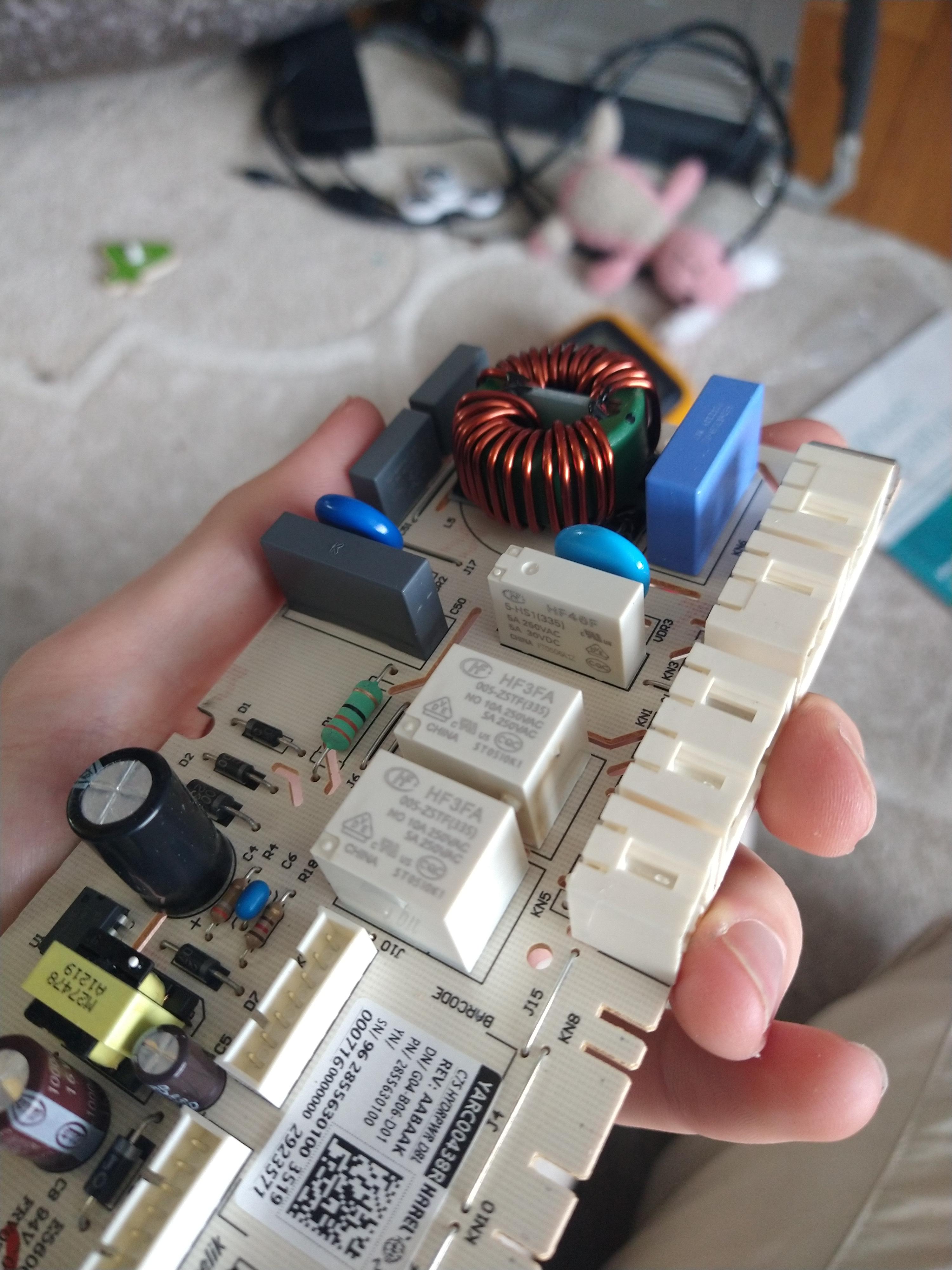

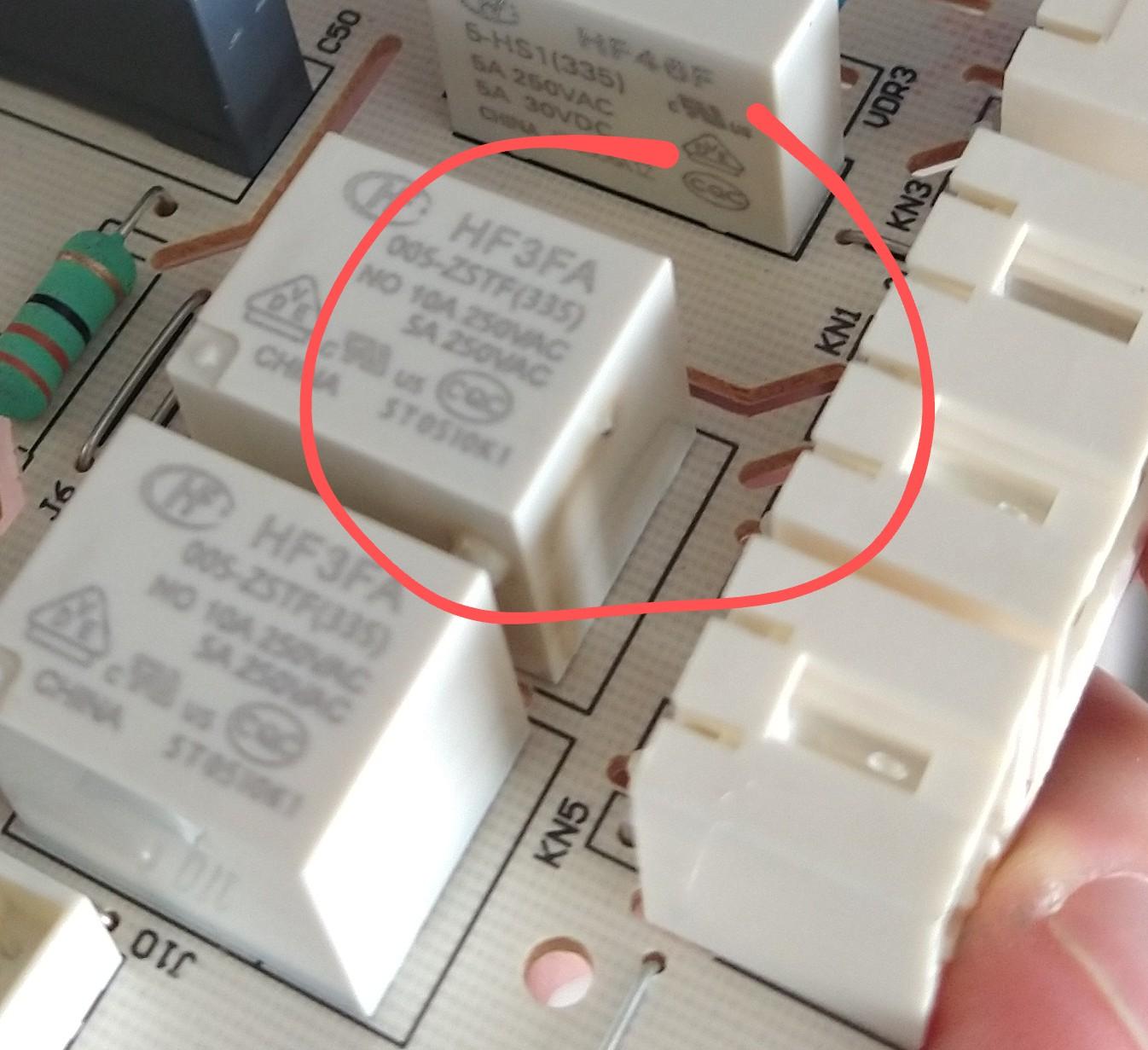

I managed to pull the main board out after first taking out the inverter (different location than the machines in the other thread). One of the HF3FA relays appears to be blown - one of the legs has de-soldered itself as well. Is this likely to be the causative fault or would this be symptomatic of something else?
I would like to replace the relay, but I am likely to be ejected from the household if there isn't a working washing machine in the next couple of days. We have a new machine ordered but I'm tempted to cancel and try to fix it.
Any thoughts? And any ideas of high street retailers who would stock relays like this?
Hi. I would have thought any actual fault you can see on the PCB is reasonably likely to explain the fault on the washing machine. The problem is there are no spare parts available in the white goods trade.
The only way to fix them is to know enough about electronics to be able to source proper equivalents from a different industry. As white goods appliance repairers don’t repair them we don’t know anything about fixing them or sourcing parts.

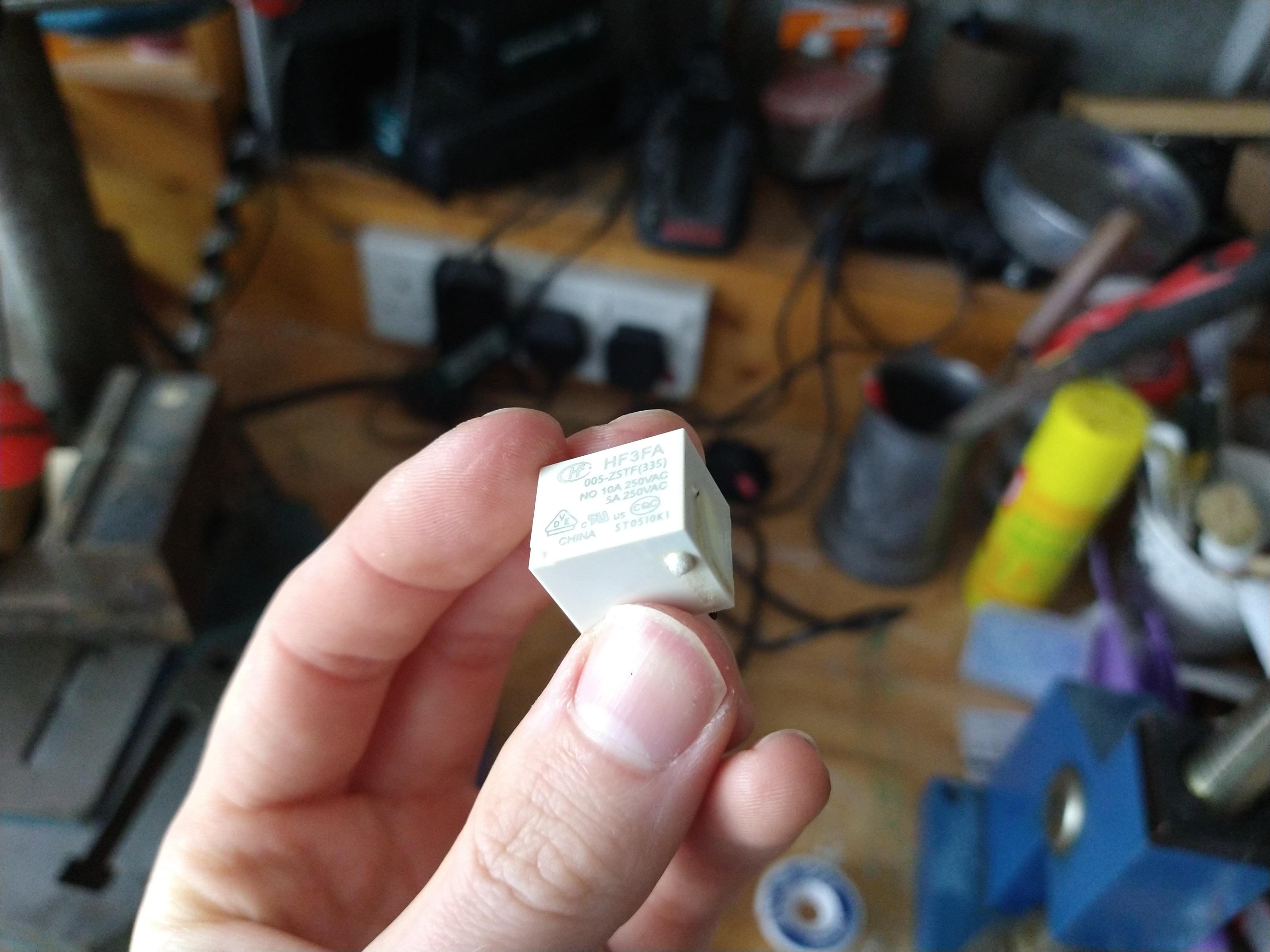

Easter is delaying things a bit, but I've got a replacement relay coming on Wednesday and an ultimatum to get it fixed before the replacement is delivered. I will keep you updated with the result.

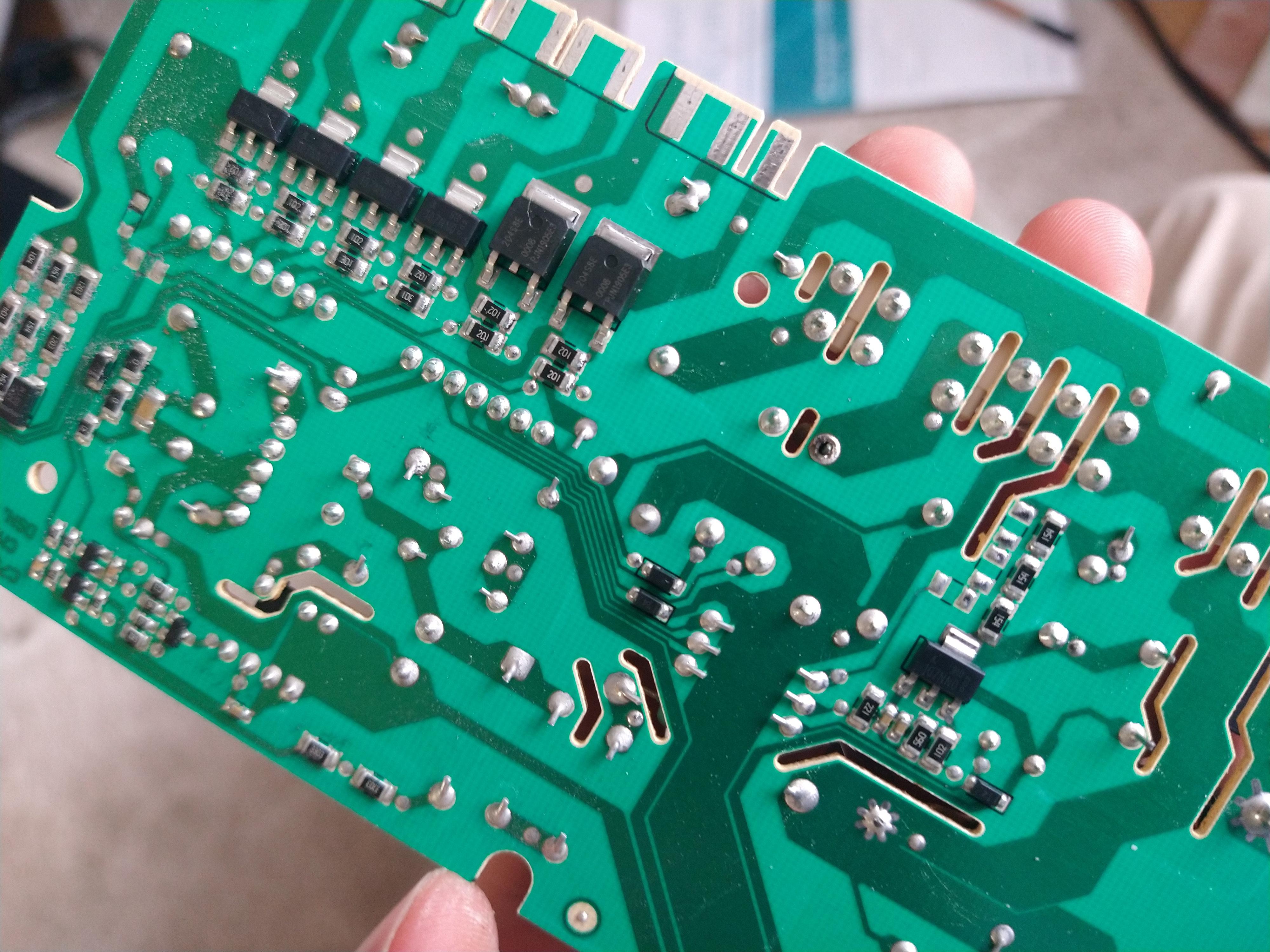

Well, I gave it a shot. I replaced one then both of the relays and ran into the same problem. This is getting to an electronic engineer realm, as the relay that burned out before can be heard clicking and visibly arcing/sparking.
