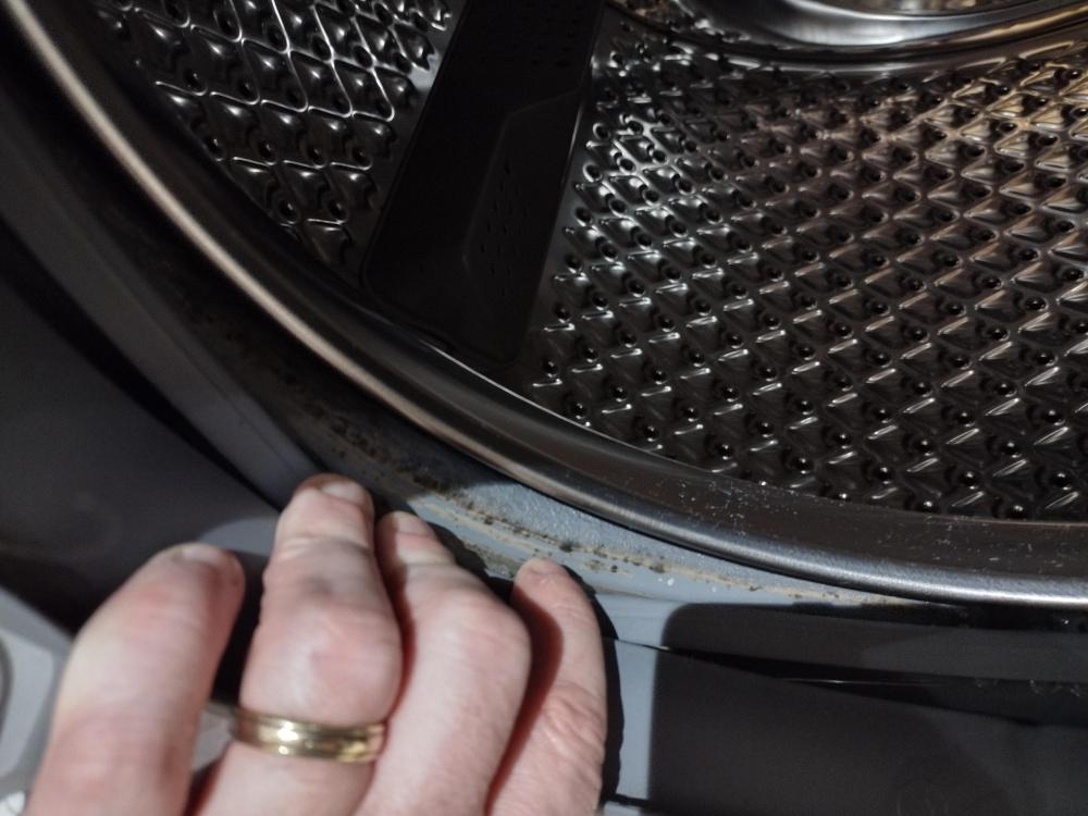

Peel back the door seal at the lip of the inner drum. Have a good look underneath the door seal. Is there any “gunge” there?
Do you use liquid detergent? Do you mostly use low temperature washes?

Had a look at that part of the seal. There is some muck,and what looks like mould spots there. Also rather worryingly there is a coating of grey sludge, although it doesn't smell at all. I've added a photo. Thanks for the help...

The edge of the door seal looks like it’s breaking down and soft, tacky? That’s not to be expected at such a young age. Could anything unusual other than detergent and fabric softener be getting into it?
Not as I know of.... We only used to use washing liquid, only recently started to use fabric conditioner as well. Could this be the cause of the smell .... We did used to use powder and tablets, but this caused the washer to badly foam up, no matter how little we used.

Sorry for late reply, Chrish. The rubber deterioration I can see is usually associated with when people used to use nappysan to per soak cotton nappies (that's mostly fallen out of fashion, I'd have thought) or doing boil washes all the time. The rubber is breaking down, and that's not normal wear and tear. It's usually caused by excess heat or some sort of chemical reaction.
