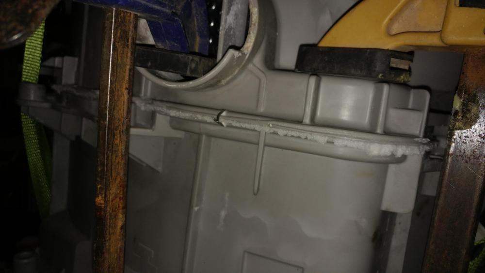

All good so-far after 4 weeks of roughly daily use.  The adhesive I used was Permabond TA4610.  I think the only question mark is the longevity of the repair against the oxidising agents used in laundry detergents.  If it fails (or we otherwise get rid of the machine) I'll reply back here. BTW the machine is a built-in appliance (around £500 new I think), so was up at the upper end of the price range which have been built with sealed tubs I think.
The repair method was to use a tenon saw to cut the tub along the weld (removing the minimum amount of material, and keeping the cut as straight as possible). Before applying the adhesive, the surfaces were smoothed using wet-and-dry paper using progressively finer grades (to remove all visible scratches, and get the surfaces as smooth as possible - unusually this is necessary with this combination of plastic and type of adhesive), and to minimise the bond thickness (max 1mm for this adhesive, but less is better). A few extra minutes spent cutting carefully is well worth it in this case. The tub was then held together with clamps and ratchet straps overnight whilst the adhesive hardened.  I'd guess we used just 25ml of adhesive altogether - cost about £7, but could probably have used less than half that, since a lot was squeezed out of the join after clamping (see photo).
