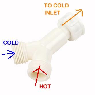

andyr12345 Posted February 1, 2022 Author Posted February 1, 2022 Andy You know you were saying about the gunk of washing liquid as opposed to using powder , is it because its cold water fill / cold water inlet only and just does not dissolve the liquid totally ? I have one of these T-Pieces , is there any advantage of me adding it to the washing machine so I have hot and cold water pipes going to it and the 1 outlet mixed to go to the cold water inlet? - I realise the water will still only be warm and not hot because of the amount of time the water will take to get from the header tank in the loft then through the copper cylinder immersion tank and then to the washing machine downstairs - and that the clothes at the end of the wash may come out warm but do you reckon the warm water rather than freezing cold water will help keep the washing machine free from gunk from the washing liquid? Here is Setup I was thinking of doing:
Root Admin Whitegoodshelp Posted February 2, 2022 Root Admin Posted February 2, 2022 Hello Andy. No it's caused by the fact that apparently for technical reasons I don't understand they are not able to put bleaching agents inside liquid detergent. It's the bleaching agents that help to prevent the buildup of grease and grime and bacteria although wash temperature is also key. It's definitely possible to set up a system like you describe although the washing machine would have to be several inches away from a wall in order to accommodate the Y piece that would have to be connected directly to the water valve. Also any knocks to this while peace could potentially break it away and cause a flood. Of course an alternative way would be to attach a hose to the single connector on the Y piece using a fill hose extension adapter which changes it from female to male and then have the Y piece laid on the floor. The whole setup is a bit messy so would not be ideal at all or even practical if a washing machine is installed under a worktop in a kitchen. You point out one of the main disadvantages in that there would be very little if any hot water that would get into the washing machine on the wash cycle. You would get hot water in during the rinses though because by the time it is doing rinses there would be plenty of hot water in all the pipework. There is an argument that it might rinse laundry a little bit better if it is rinsed in warm water rather than stone cold though not necessarily because warm water tends to excite soapsuds and cause more so it would depend on how many rinses a washing machine does and they try to use as little water as possible these days. andyr12345 1 Need a repair or spare parts? Book a Repair | Spares4Appliances WARNING: Read this before attempting any diy repairs. No representations or warranties are made (express or implied) as to the reliability, accuracy or completeness of advice. I can't be held liable for any loss arising directly or indirectly from the use of, or any action taken in reliance on, any information on this website, which is given free of charge and in good faith.
