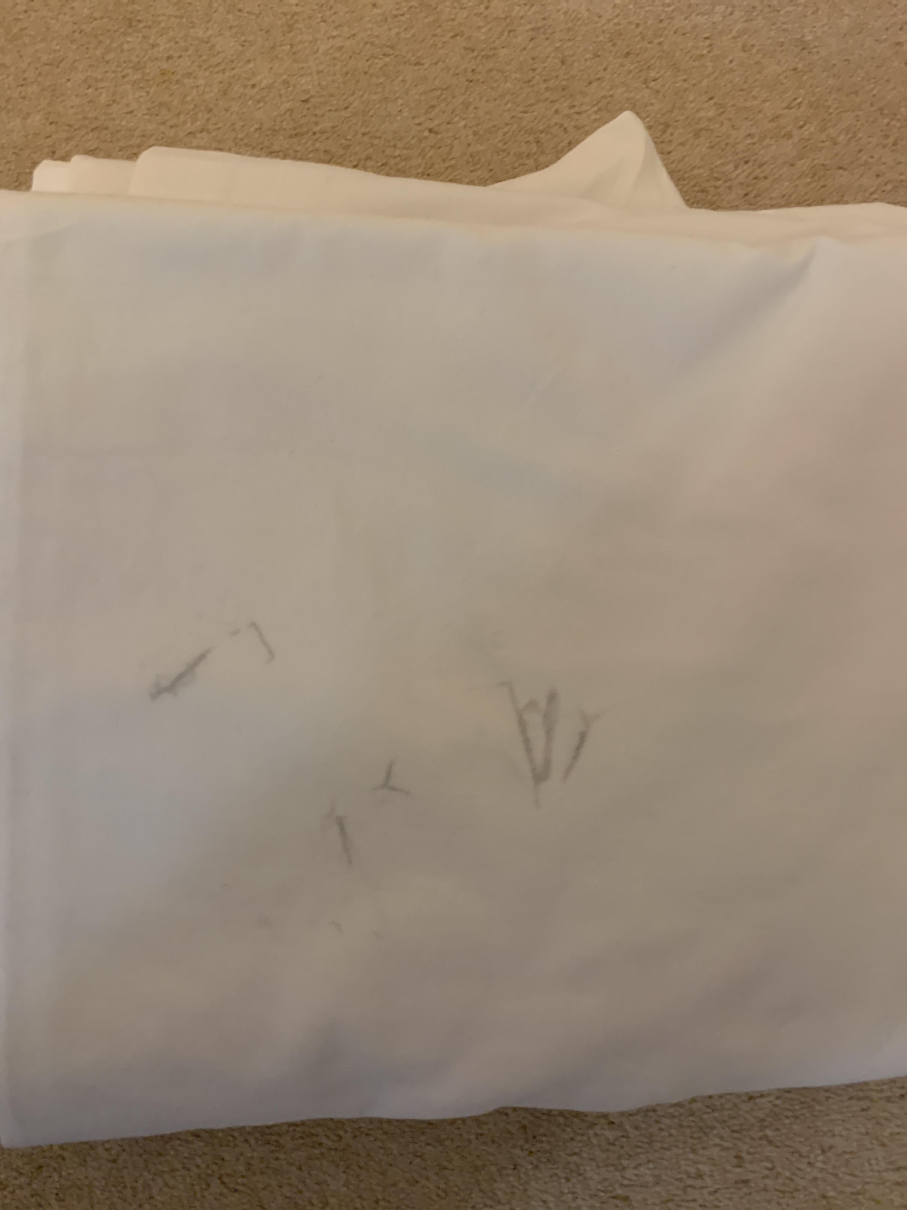

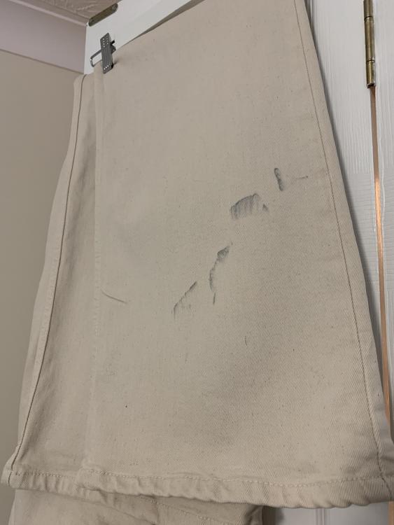

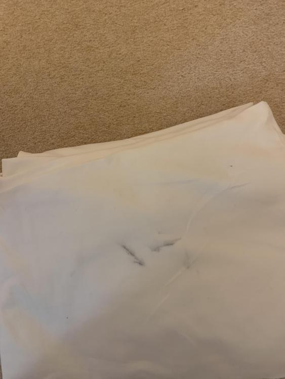

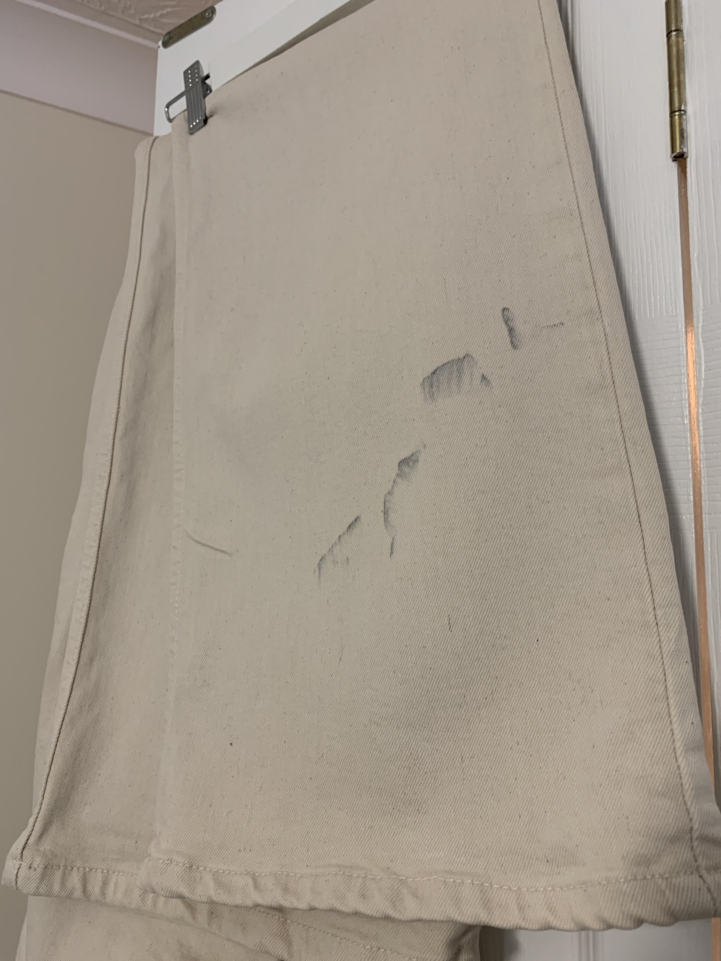

I keep getting black streaks and marks on white washing from my Bosch washing machine / tumble dryer. I have has a service engineer come out and he could not find the reason replaced the door seal. First was after this and it happened again on a pair of cream denim trousers. The machine is 1 year old.  and this started about 6 months ago. Has anyone else had this happen

If you could post any photos it might help too.
Try getting an old light coloured sheet or cloth and see if you can replicate the marks by dragging it firmly around the door seal where it meets the lip of the drum and up at the top where the vent for the dryer is.
Essentially, as the laundry is inside a steel drum and the marks are long it can only really be caused by laundry getting trapped and dragged around the door seal.
It seems to be common in washer-dryers though manufacturers usually blame overloading.
