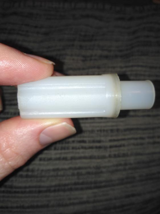

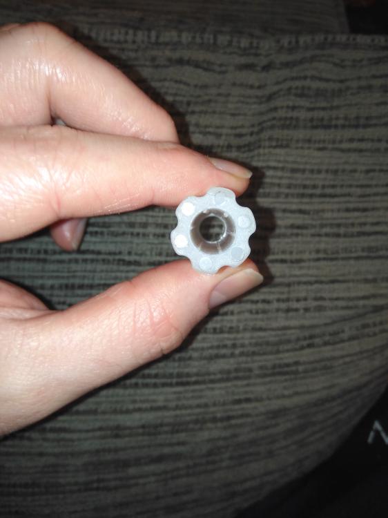

When.tipping the washing machine on it's side 2 identical components were rattling around inside the bottom. I've attached  pictures.
Does anyone know what they are and if they could be part of the problem?
Any help is much appreciated.
Hello there. They could be part of the transit packaging. Especially if you had to remove any bolts to remove the transit packaging.
