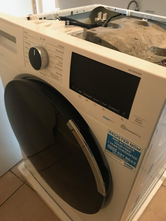

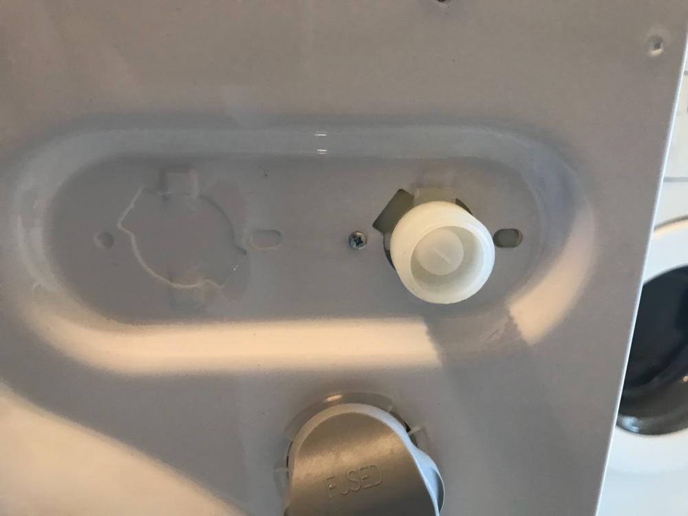

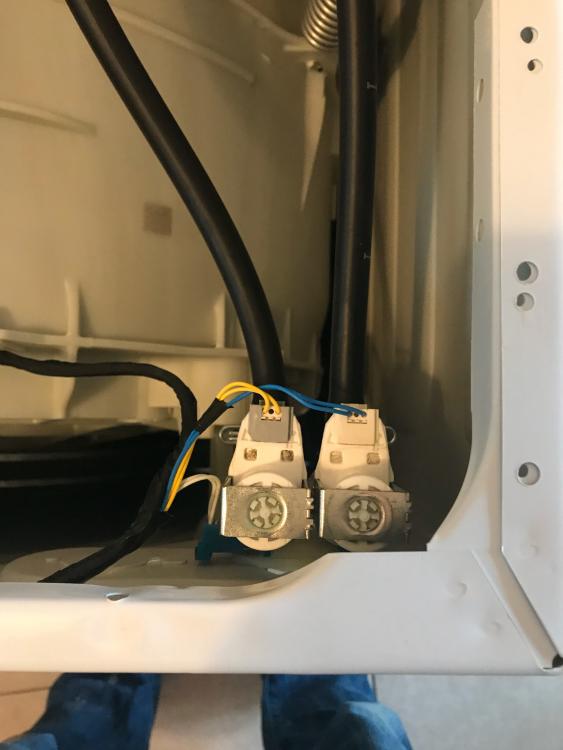

Hi!  Just wondering if anyone would know the part number required to make our Beko accept hot and cold feeds?  There is a blanking plate ready for a hot feed, and internal workings would seem to indicate that it's happy to accept a second valve.  The washing machine we removed had both and Beko clearly do hot and cold feeds but not in all countries, I guess its a UK thing.
Thanks!
stan
Hi. I would think it isn’t possible. The programmer would also have to change to use the hot valve, and all of the wash cycles would need to change because cold fill wash cycles are different to hot and cold fill cycles.
Manufacturers are likely to use the same cabinet for cold fill only and hot and cold fill because it would be too expensive to produce different ones.
To be honest there are very few hot and cold fill washing machines and most manufacturers moved over to cold fill only at least 10 years ago. I wouldn’t be surprised if many of them never changed the main cabinet and just blanked off the hot valve hole.
For most people a hot valve is a waste of time anyway as explained here I want washing machine with a hot water valve
The article also explains how even washers with a hot valve just don’t use it properly so for most people it’s a waste of time.
Also I can’t see anywhere on the soap dispenser to attach a hot fill hose.
Thanks for that!  Case (it would seem) closed.  Extremely thorough.  I thought perhaps the two tubes leading from the inlet valves related to hot and cold but clearly not.  In the Beko literature / manual is does mention that hot and cold feed models exist, so I have emailed Beko on the off chance they will have a swap out but I suspect not.
