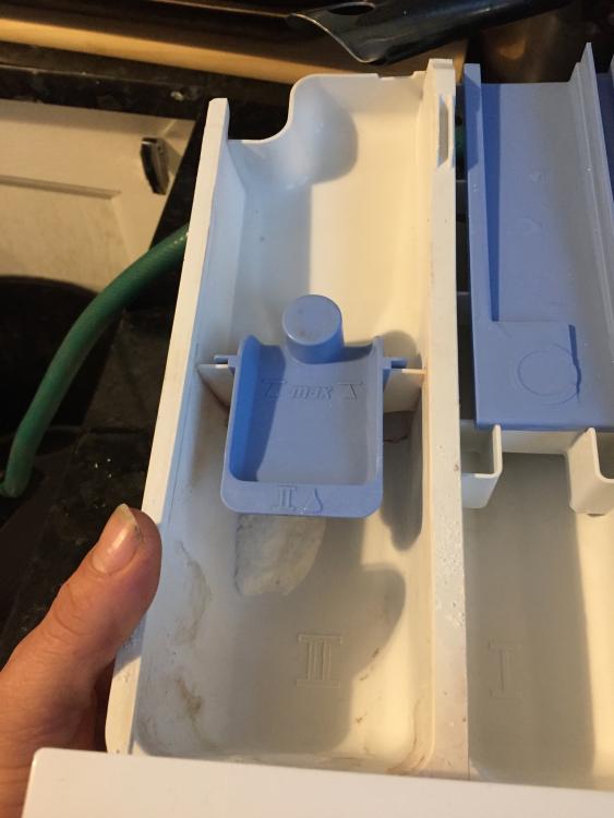

The leak is coming out of the top back of the detergent drawer housing (where it clips together I have taken this apart to give it a good clean etc and thought that this should poss have some sort of gasket but there is no evidence of that?
I removed the plastic tray for liquid to see if that helped but there was still some clumping and also the leak (all with the water supply turned down a bit) see second pic.

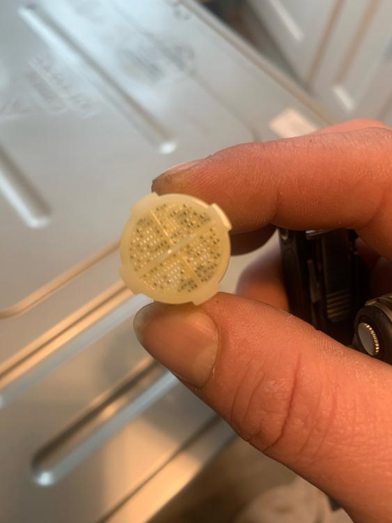

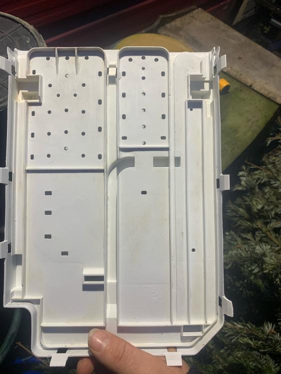

So I have now taken out and cleaned the filter in the water valve. It did have a load of little bits in (see pic) but I still wouldn't have thought it would make that much difference? I also ran air compressor through the top of housing to make sure no jets where blocked (pic to show it is really pretty clean).

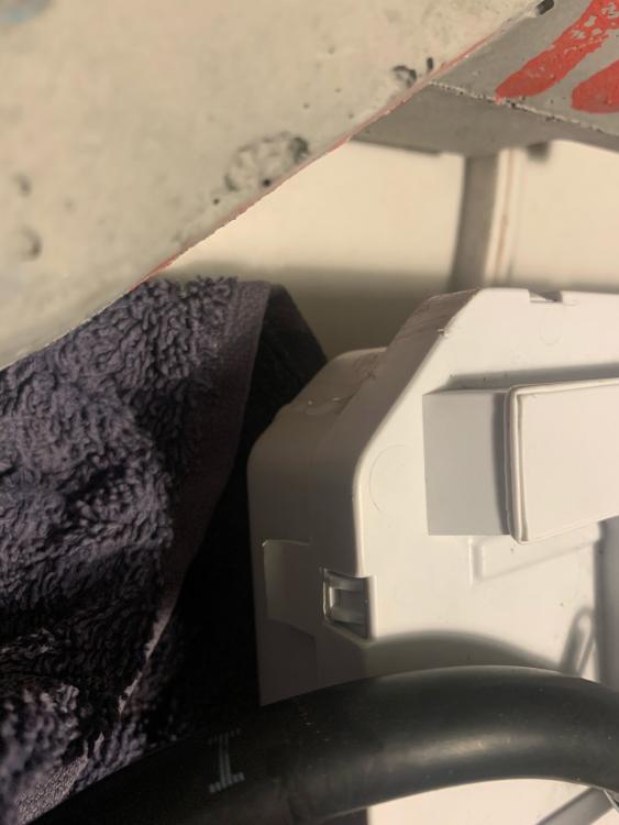

I have run a load (no other water being used in house to be sure) and have the leak still (see pic).

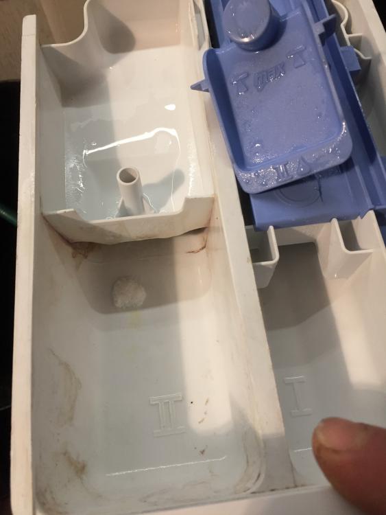

I did another wash this morning and no leaking! the only difference was that I took out the little shelf for liquid.
This does at least mean that I had no clumps as the clumping is always under the little shelf and so the water jets are unable to wash away properly. but I do end up with the liquid drawer full of water (I can't quite see how this is meant to drain away anyway as there are no holes at the bottom etc?)
