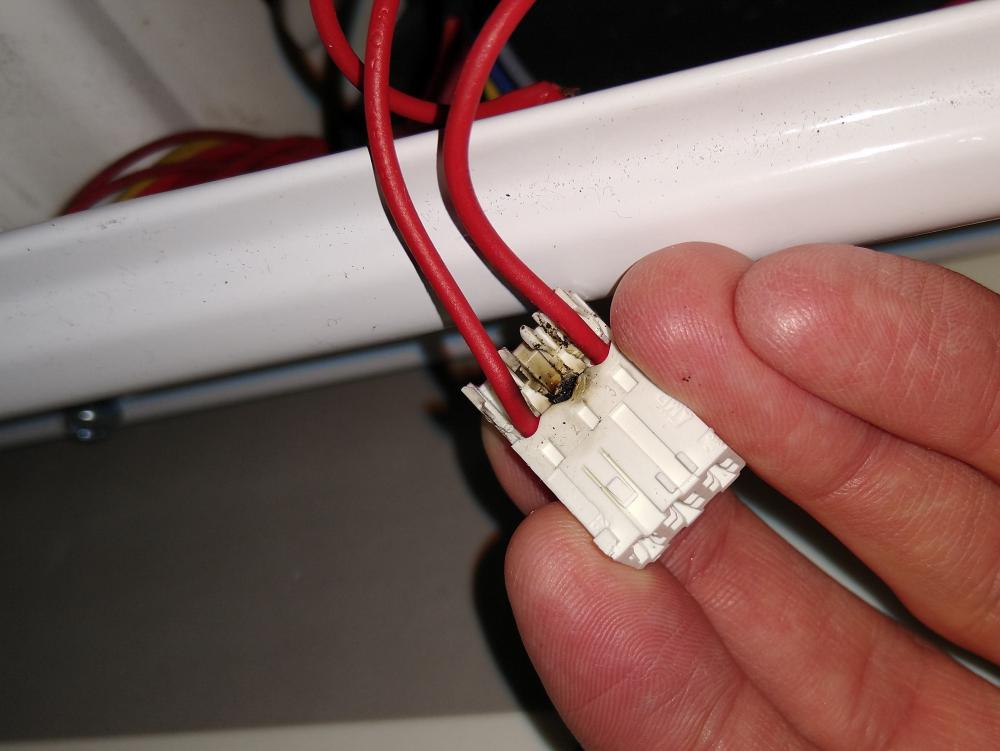

Local repair company appear to have now found the problem. See the photo - a wire has burnt out and come away from a connector. This is down next to the motor.
I don't feel comfortable replacing the wiring so they will be doing it for us. It's a cheap enough job that we'll give it a go, but they did warn us it's not a guaranteed fix.

Thanks for the update Chris. Clearly that is something that needs sorting out. However, I can't see how it could possibly account for any resistance in the drum. Isn't it a disgrace how poorly made appliances are these days. There's no excuse for wires overheating like that. It's just poor quality connections.

Just in case anyone wonders what happened - replacing this wiring harness has solved the problem.  Maybe I didn't describe it very well initially?
We paid £30 for an initial call out.  £90 for the parts and labour, with the original £30 then deducted, so a grand total of £90 which, although ridiculous on such a new appliance, wasn't too hard to swallow!
