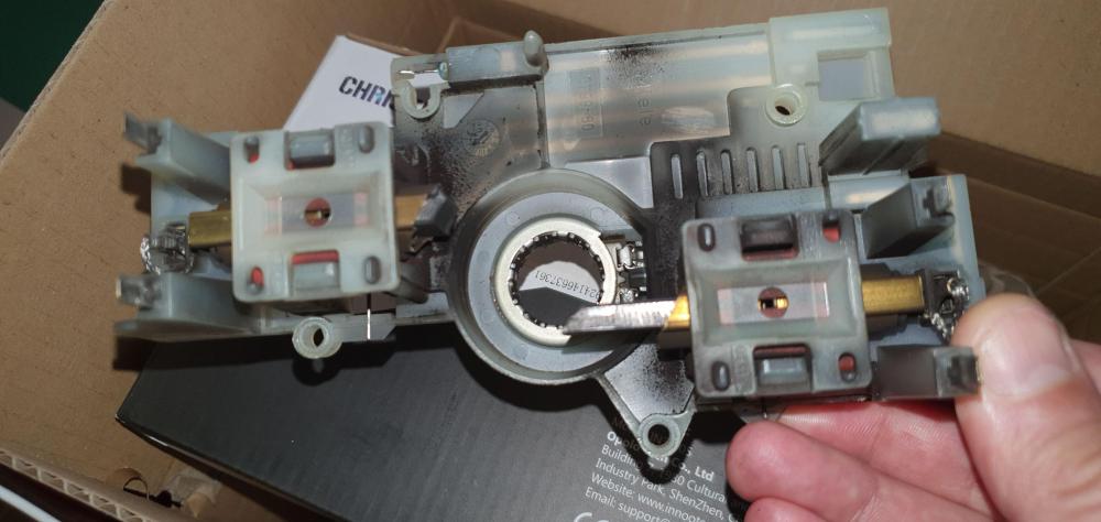

Nice one. Is one or both charred? If they are not making contact one or both should be charred. If they are both shiny, even though worn down they are probably still making contact with the commutator and may not be the fault unless they are extremely worn down. Check this page carbon brushes diagnostics
One was really badly worn. Worried if motor on way out. Will clean up motor as well with emery paper. Waiting on brushes. Hope can out back together easily enough.
The one on the left looks jammed. Is it charred where it runs on the commutation? The one on the right looks like it has another 10 years life in it.
Looks promising that this is the problem.
