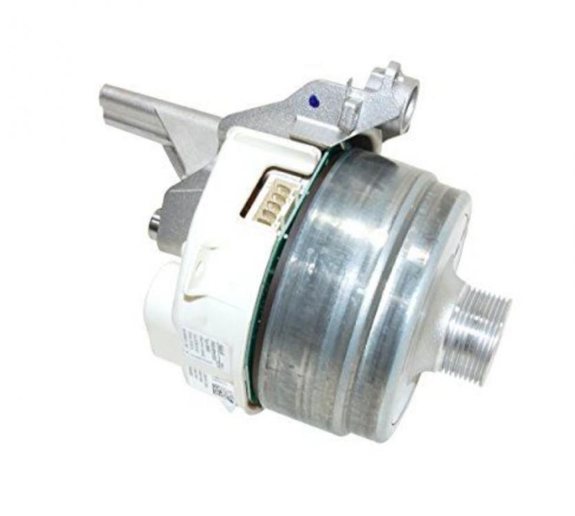

Hoping that it might be a carbon brush issue I have removed the back and motor however it looks like a sealed unit (no way to access brushes). I attach a photo of the motor (available to purchase for more than I am willing to pay for a replacement part).

That looks like a puny little motor. It's a disgrace what they charge for them. The way to test the motor like that is with a continuity test meter across the pins. However you need to know which pins to test down. You could try testing with the multimeter continuity test meter to see if you get continuity across pairs of connectors but there are an odd number so maybe three of them are all connected if it has a split field coil.
If you can get continuity across all of the connections it would imply the motor is electrically sound. But ideally you should work out where the connectors go if you could take off the white cover by any chance. The motor is probably made to be unrepairable. It would be very unwise to just gamble on buying a new motor even if the price was palatable. If it isn't the motor at fault you need to check all of the connections on the motor plug and the motor wiring harness. And test continuity between each connector on the motor plug all the way back to the PCB. You would also need to check the connector on the PCB. If nothing is found then the PCB could be faulty but again, neither part is cheap enough to speculatively gamble on buying.
