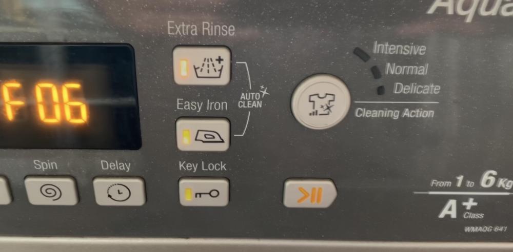

JCB Posted October 21, 2018 Posted October 21, 2018 Hi everyone, I have tried a few things, powering off etc to fix this to no avail. It’s 3yrs old. I can run a wash cycle no trouble, sometime after F06 will show and the buttons flash, only way to stop this is to power off. If you don’t power off it will then randomly try to drain by running the pump - which is a bit worrying... The door lock light is also permanently lit. Any ideas? Thank you
Root Admin Whitegoodshelp Posted October 31, 2018 Root Admin Posted October 31, 2018 The only Hotpoint error codes I have that uses F06 are the EVO2 software machines but they are some years old now. It refers to pressure system faults. Possible jammed pressure switch or blocked pressure system. However I don't know if it is applicable to your model. Need a repair or spare parts? Book a Repair | Spares4Appliances WARNING: Read this before attempting any diy repairs. No representations or warranties are made (express or implied) as to the reliability, accuracy or completeness of advice. I can't be held liable for any loss arising directly or indirectly from the use of, or any action taken in reliance on, any information on this website, which is given free of charge and in good faith.
