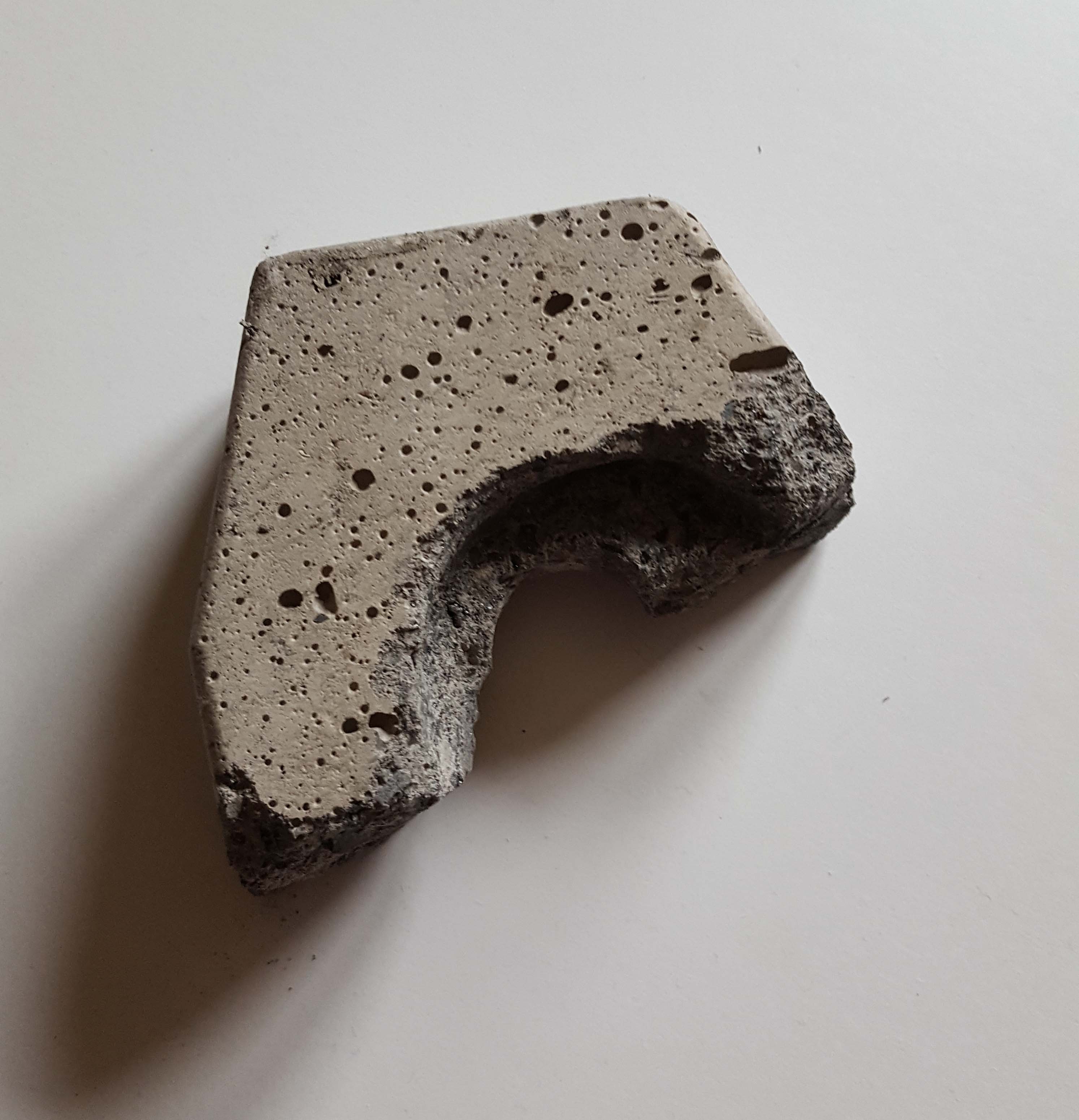

I have just had another look and this time found a chunk of the front weight and a pile of dust on the floor!
I have seen the part on the Hotpoint site for about £31 inc delivery, but is it easy to fit?
Also why has it come loose, could there be another fault that has caused this?

Difficulty varies. You will need to strip off the front. Some washing machines have welded fronts so the whole tub would have to come out. Very big job.
The bolts holding these heavy weights keep coming loose. It doesn’t help that they screw  into plastic drums. Sometimes the loose weight shifting about can damage the fixing for the bolts or even shear them off. Then a new outer drum is needed.
The only thing you can do is try to take off the front panel to inspect it.
Thanks for the update Tony. With this fault it is vital to catch it early. So many people just ignore the noise until the tub weight has ripped off the plastic moulded lugs and destroyed the tub (outer drum). It's important to tighten the bolts nice and tight when fitting the new tub weight but they can be over tightened. As you can imagine if you are tightening a metal nut and bolt which is essentially only being held by plastic there is the possibility of shearing off the plastic by over tightening.  This is one of those things that you can't adequately describe to someone else unless you are using a proper torque ratchet. You have to use your own judgement.
