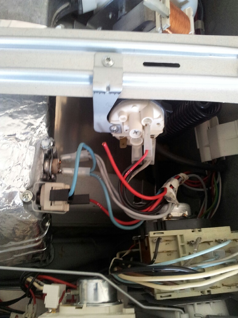

I've previously replaced the drain pump, it worked fine for a few months with the new pump. Also, found a broken thermostat connector which I soldered back together and tested. Don't think it's the thermostat though, as we never use the drying function. Another odd thing (but could be irrelevant) is this loose red wire next to the water pressure sensor. It's not properly terminated, but does not appear charred either (pic)

Fusing or tripping the electrics needs an insulation test meter to trace. A big flash is often caused by the motor but not necessarily. Could the red wire be off the pressure switch? It could be a double tag like one already on?
Thank you for your response. I did check the red double tag plastic housing, it does not seem to have the remainder of the 'cut' wire.
