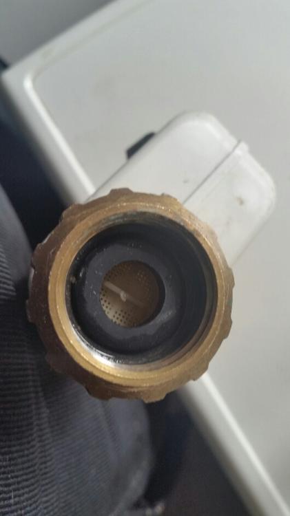

I'm referring to the connection to the water supply. I've managed to upload a photo. You can see there's a small drip beneath the brass connector, sitting on the WPS box. When the water supply is turned on, lots more water leaks out the bottom. Doesn't leak out the top of the connector.

The previous owner had a male attachment on the connector, which I have subsequently removed. The owner said there were no leaks at all at last use (she's had the machine from new with no problems), so I tried it with the male connector (with female attachment) just for good measure, but it simply leaked in more places.

As long as this hose assembly isn't wired into the washing machine you should be able to use any washing machine hose. This is an Aqua stop type hose which is supposed to be free from leaking (ironically). Their main use is that as a normal hose can split, these hoses are a hose within a hose so to speak so they are free from leaking from the actual hose itself.
If you want to keep using this one though, just make sure the whole thing is nice and clean, turn that rubber hose around, and tries some PTF tape on the male part of the thread. If you put too much PTF tape on though you will not be able to tighten the thread up enough. It could even be that the problem is you haven't tightened it up enough anyway. Another approach would be to liberally spray WD-40 on both the threads to clean and lubricate it and then tighten it up. I would not expect to get a good seal without nipping up the connection with some pipe pliers. Hand tight would probably not be enough to make the seal. If none of it works you need to buy a new rubber seal for the hose or at least try fitting a seal from another hose as they should be pretty standard in size. At the end of the day a watertight seal is made when that small black rubber seal is pressed tightly up against the male part. It needs to be tight, but as I said before if you over tighten it you will just cut into the rubber and damage it.
BINGO! Your advice worked perfectly, thank you! It was a simple case of cleaning out the connector, rotating the rubber seal and securing it on the pipe nice and tight. No PTFE required. I've run it through several washes and it's dry as a bone.
