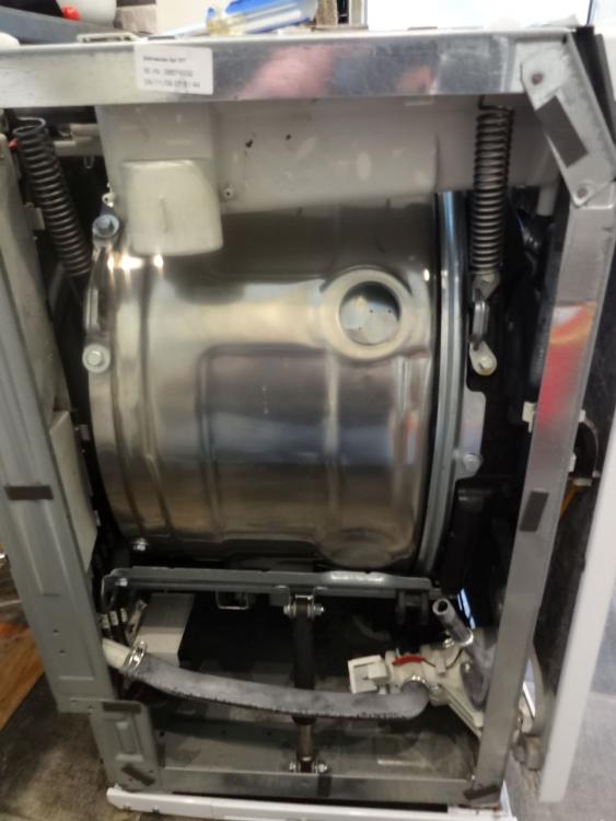

Peter H Posted November 12, 2017 Report Share Posted November 12, 2017 Well done and good - any issues, feel free to come back to me. I did not have to disconnect any wires etc as I only needed access to the screws which held the side panel on as per my photos. I do have a full list of part numbers if you need it. I had to buy a new piece of plastic which cost about £5 inc del and Miele were very helpful. I have a contact e-mail address if need be - she was amazing - none of this "better get an engineer to call" etc etc I assume you have a leak hence the flood switch tripping so may be worth getting some hose clips too as not many of the connected hoses have any clips at all - how cheap is that! Pulling of the side panel gives good access to most things - much better than the old models. Peter Whitegoodshelp (Andy) 1 Link to comment Share on other sites More sharing options...

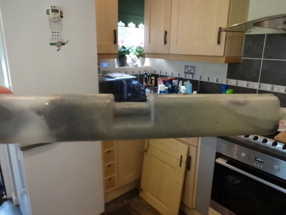

Peter H Posted June 11, 2018 Report Share Posted June 11, 2018 Another photo showing location of plastic tube - in area circled red Whitegoodshelp (Andy) 1 Link to comment Share on other sites More sharing options...
simondorras@btinternet.com Posted June 11, 2018 Report Share Posted June 11, 2018 many thanks for your Peter help no plastic on mine just rubber pipework but sure enough one of the rubber pipes was blockede fingers crossed problem solved thanx again Whitegoodshelp (Andy) 1 Link to comment Share on other sites More sharing options...
