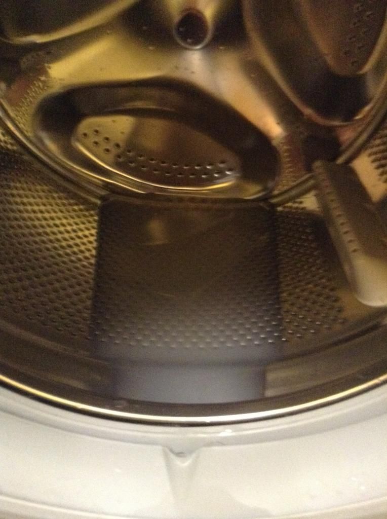

Thank you both for the help, just to confirm the pump is working fine. I stopped the wash mid cycle and just scooped the water out of the drum with a jug as daft as it sounds! Yes the machine does have an eco button on it but the funny thing is I'm experiencing the problems on the hot washes. If I use the eco button to wash in cold water it does bring the water level up to the door where it should be, its only when I do anything over 40 degrees and not eco that I'm having the problems with and Ive been topping the machine up manually by pouring water into the dispenser drawer. I guess Im just really asking whether it sounds like I do need to book a repair or not or whether it is all actually normal.
Ive added a pic to show the water level.

The 60 degree wash is the one they test for the eco labels. They may well use less water on the 60 degree wash so that they can cheat the energy usage labels. By using less water they can claim it costs less on that cycle because it will cost less to heat up a lesser amount of water. They get up to all sorts of tricks including even not letting them get to 60 degrees (Washing machines not delivering right temperature)

I'm still suspecting the pressure switch. It's shutting off the water too early. I had this problem on my hotpoint where the clothes were just getting damp for a wash. Strange thing is, I installed a new pressure switch and there was little improvement. I noticed small adjusting screws on the back of the switch and I discovered that altering these let me change how much water went into the drum. I'm not kidding when I say this is very fiddly because one slight turn and the drum fills to the top. Now my clothes are actually buried in water. Have you tried blowing down the plastic tube inside the machine? which runs up from the bottom of the drum to the pressure switch?
