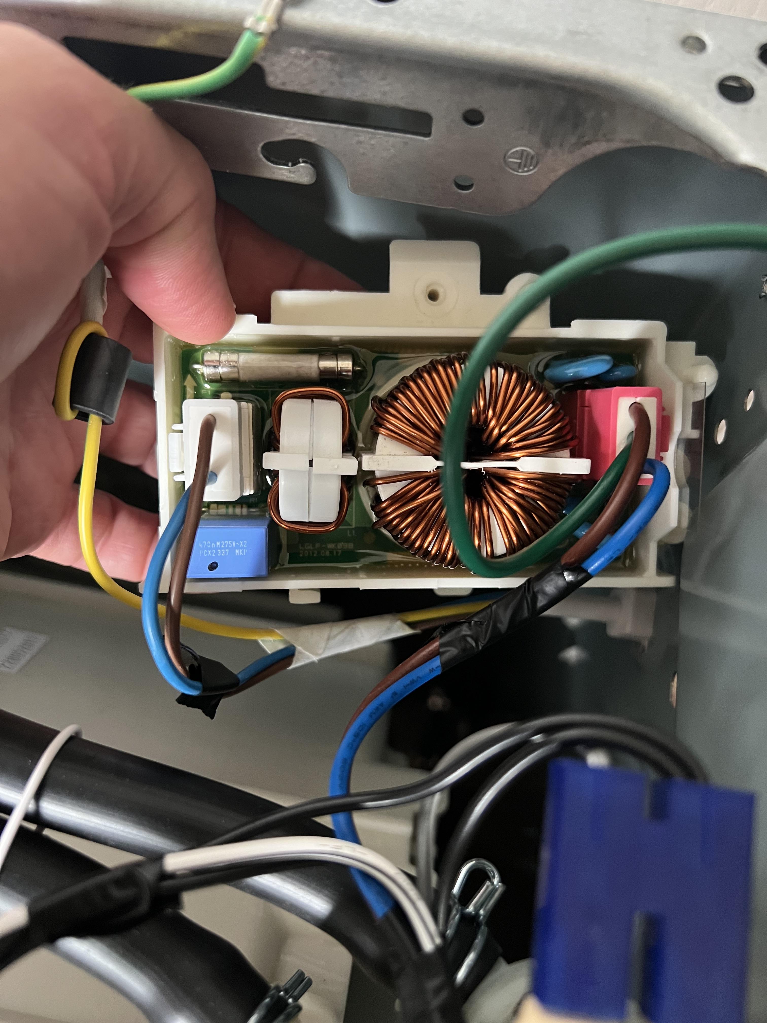

Looking (carefully) inside, there doesn't seem to be any fuses, other than in the mains power filter. Have checked that, but it seems good.

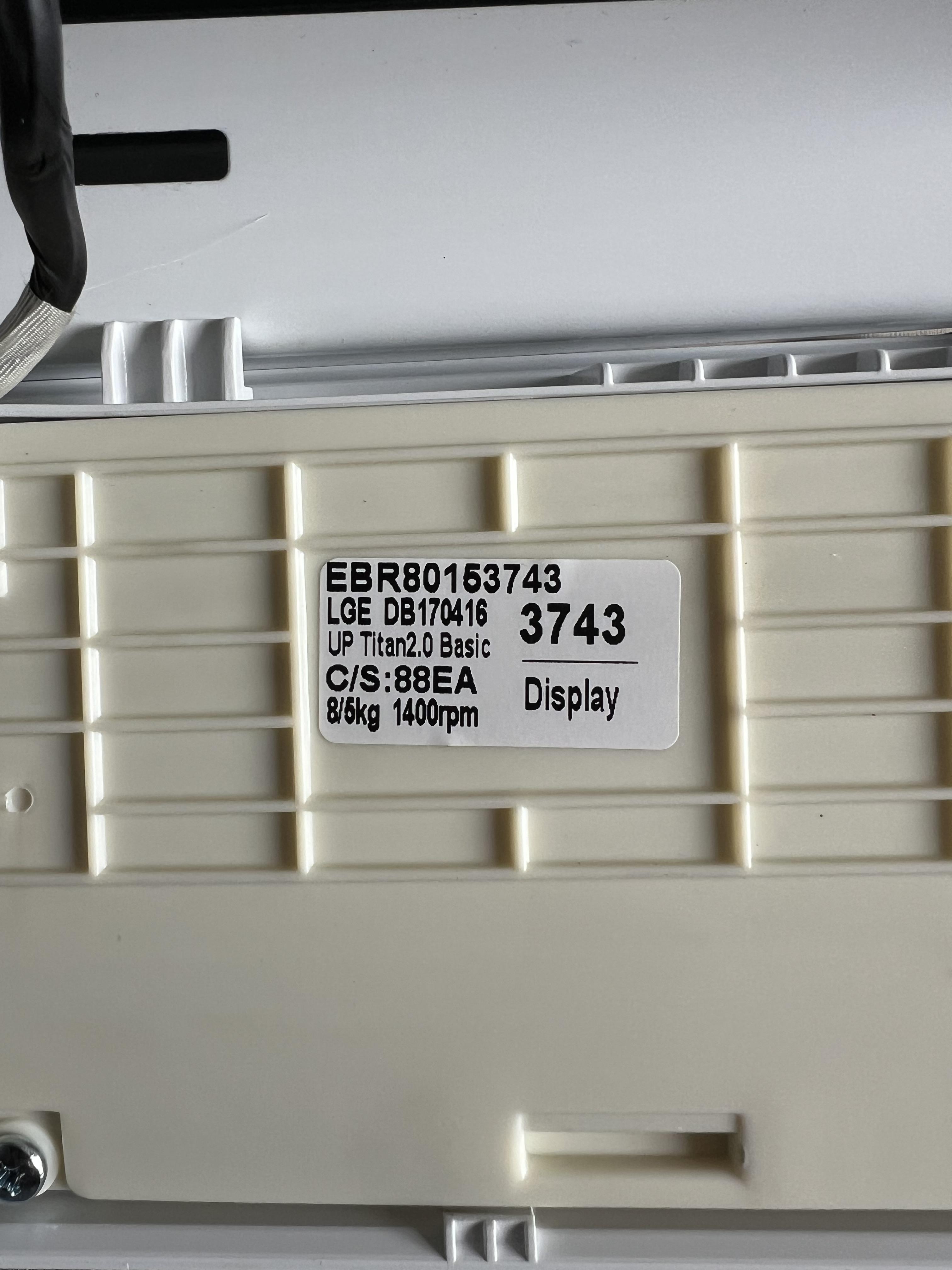

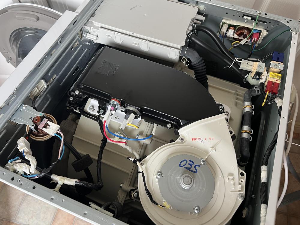

As the current machine is being scrapped I decided to dismantle it to look for the main PCB. Found it and nothing obvious wrong. There appears to be two fuses on the board, tested the main one, seemed OK, the other smaller one is covered in resin so can't easily test.
