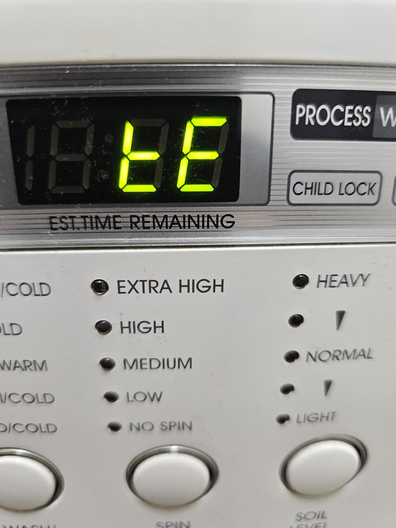

I'm new to the forum and I'm trying to help my daughter get her LG Tromm washing working again.  It's a front loader model WM2277HW. It can start but only runs for less than a minute and then it codes but the code doesn't make sense, I added the picture of the code below. So far my grandson has replaced the rotor position sensor but still isn't running. If anyone can help it would be greatly appreciated.
It could be supposed to be "te". If so that means "thermistor or element fault"
The problem with error codes is they are just a guide for engineers to know where to start looking and testing and never really tell you exactly which part to replace. They can even be wrong too, or turn out to be connection faults.
Thanks for the response and advice. Much appreciated
