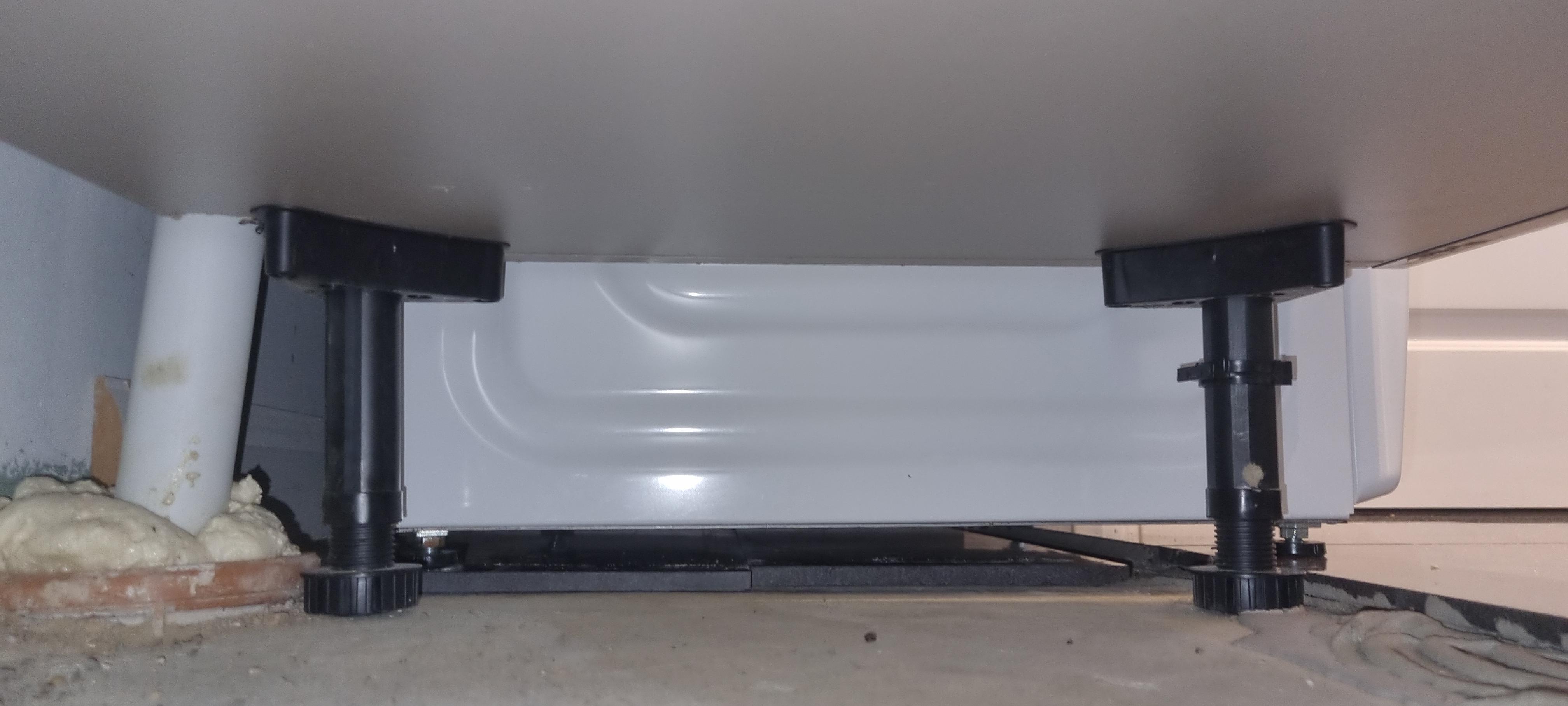

Yes, the washing machine has adjustable legs that we tried to level as much as possible. The space at the back of the machine is hard to reach so we can't check the level at the back using a spirit level. It stands on the leftover tiles we had but they aren't cemented or attached. I'd say that it's moving only at the beginning or end of the rinse / spin cycle now. There's also a noise coming out of it as if something is hitting it. The second I push a bit against the top or put my hand on the right hand side, the sound stops. I'm attaching pictures of the side profile and a video with the washing machine moving a bit.

The back tiles could be moving a little if they aren't fixed. The back times also seem slightly lower and the front feet are raised. So its possible the washing machine may be sloping backwards. That could allow the rotating drum pulley to catch on the back panel.
The only thing you can do is level it as best as you can and put up with the movement or get it out and have the floor properly levelled.
