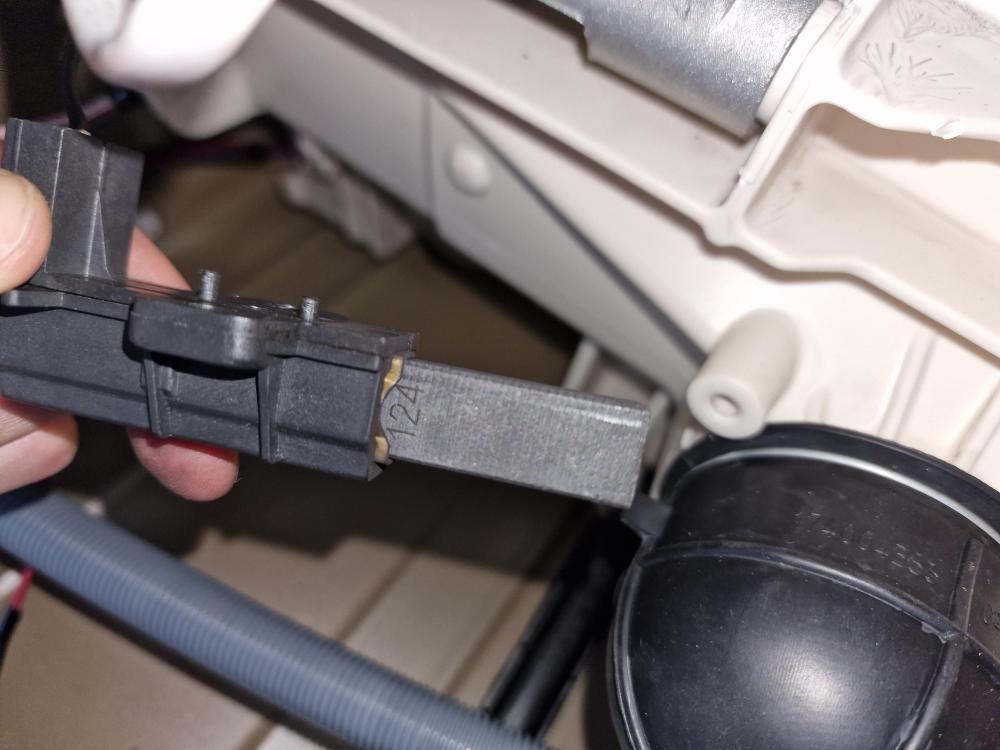

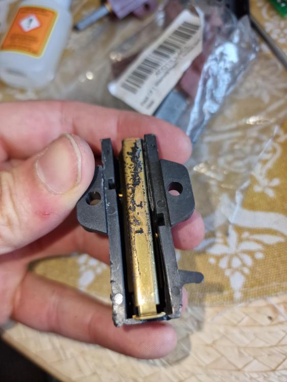

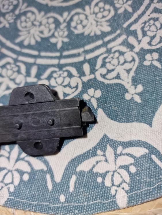

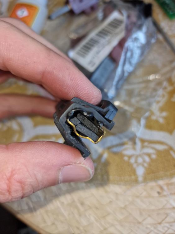

Thank you very much for informative answer. Hotpoint pointing specifically to pcb board fault and maybe triac component. What i find out that clicking sound from pcb board can make relays and worth to check brushes on motor because worn brushes not allow to start motor. I take off 2 brushes and they very different on wearing. May you can advise or that 1 brush need to be replaced? Maybe that's reason why everything is working and worn brush not allow to start motor?
Edited by Efectaz
Looks like one has jammed. If it’s actually worn that’s a hell of a weird thing. I have a link to spares site in my signature for Ransom Spares. I’d go there and look up the carbon brushes for your model.

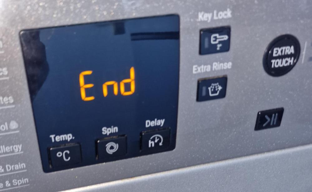

I bought new brushes and changed jammed one also all brush case was damaged you cant even open it without brake it and it's start spining again!!!  Machine is 2.5 years old. Model:
So symptoms was :
clicking noise from pcb board.
F01 error which is saying about faulty pcb board or motor triac short.
Drum not spining at all but machine can pump in and pump put water.
Hopefully it's permanent fix 🙏
Thanks for your help.
