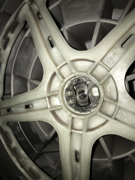

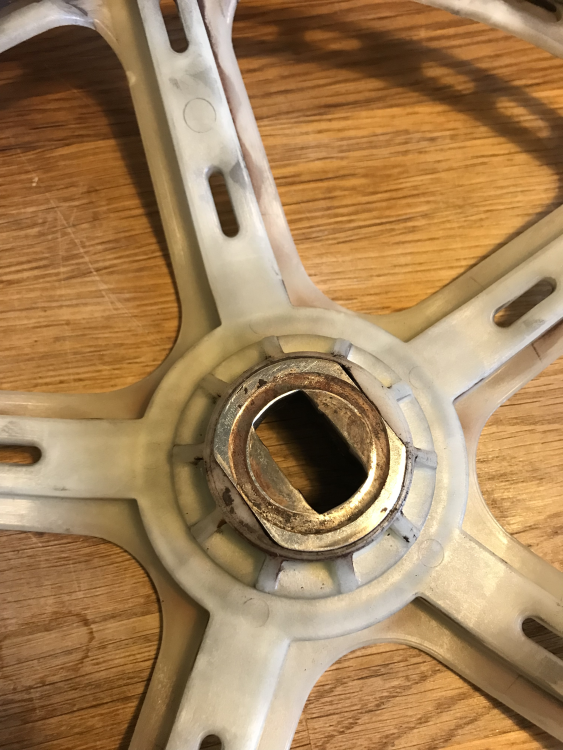

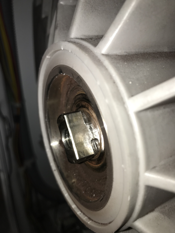

I have an Ikea Renlig machine (made by Electrolux I believe) from 2015. The belt started to come off so I replaced it by a new one but that didn't help. In the end I found out that the reason is a loose drive pulley. The drive pulley wobbles which makes the belt come of affter a couple of spins. It has also a bit of play in it when turning it in alternating directions.
I can't figure out what part is causing this. The shaft seems to be a bit dented right where the metal plate in the drive pulley is attached, but in a way that I'm not sure if it's just how it's manufactured. See some pictures below.
Any advice would be really appreciated.
Hello there. You just need to replace the drum pulley. It is the drum pulley itself that is worn.
