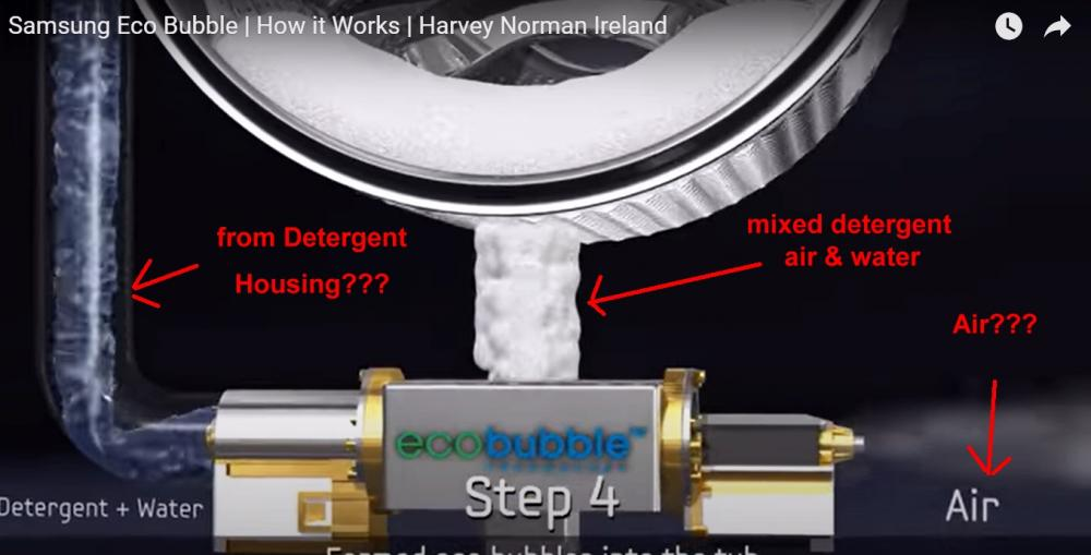

with our samsung washing machine In the marketing blurb it says that the Samsung ecobubble washing machine mixes water / air plus detergent to help lift stains and dissolve them (something like maybe that vanish oxyclean stuff I suppose does in that way) but i am a bit skeptical (as normal LOL)  - I wonder if thats true about the air?, and without me taking apart the machine and looking at the ecobubble generator what do you reckon?
I mean if you just had a bowl of water and just mixed the  liquid detergent with your fingers, no air involved its going to all mix up regardless isnt it and bubble up ?
even my washing machine does not represent this graphic , because I have had the top off and the big black hose goes from the bottom of the soap dispenser drawer  straight into the top of the outer tub same as nearly all other washing machines ... and not down to the ecobubble generator like in this graphic representation:
What do you reckon ? just another marketing gimmick or do you reckon it really does mix water/air and detergent together?

thanks for the reply Andy.
if there is one thing I hate its being lied to ... but not only that being lied to by big companies I am about to part my hard worked wonga on 😄
If I see their graphics and ads saying it does this and that and it dont do it like they have advertised I feel ... er done! LOL
Take that graphic of how they explain ecobubble works - if I see in that video that the detergent and water gets taken all the way down to that bubble generator and mixes water air and detergent then thats what I want to see when I take the lid off my washing machine! - not just going from detergent draw straight into the outer drum like all the other same (cheaper basic) machines. Plus I read another feature is a 'stay clean drawer' powerful strategic jets aim precisely to clean the soap drawer apparently - so as a test I spilt some detergent on the top surface of the drawer ..... its still there lying on top after about 5 washes I have done now .

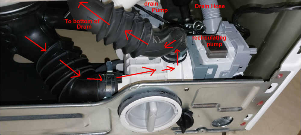

curiosity got the better of me today ... I wanted to look at this marvel that is 'The Samsung Eco Bubble Generator'
If you look at Samsung's marketing and video's this is how their wonderful ecobubble system is supposed to work on their range of ecobubble washing machines
Here is a video explanation of how it is all supposed to work, very techincal system, mixing air/soap detergent and water to provide lovely aerated bubbles to dissolve and lift stains from your laundry:
https://youtu.be/UD1nbWLk_wI

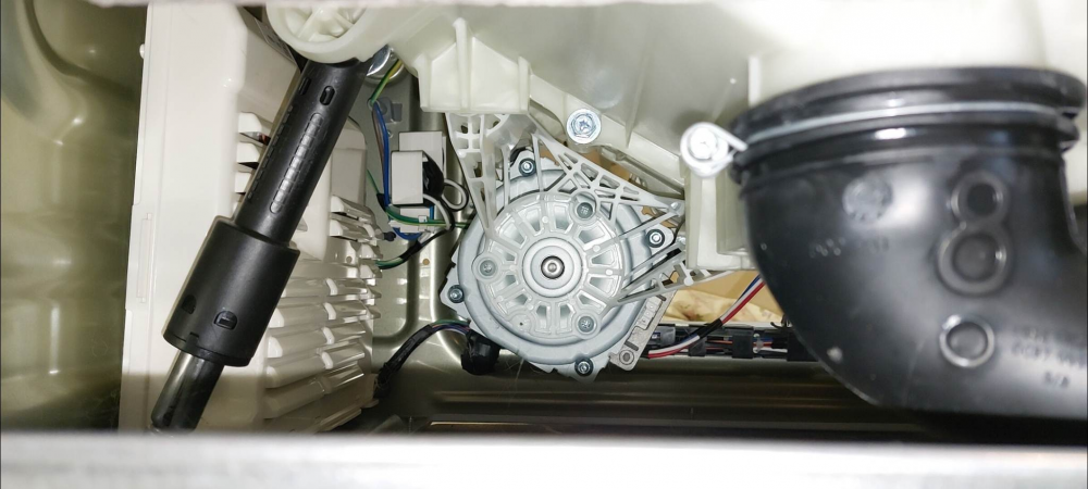

- so I have taken the front off the cabinet.
So guess what , there is no magic bubble generator, cannot say I am surprised.
all it is , is a separate recirculating pump attached to the side of the drain pump,
the water travels down the sump hose, to the recirculation pump and then (must) take the dirty water from the sump and just recirculate it up into the bottom of the drum again , just recirculating dirty soapy water , i doubt if there is any kind of filter (apart from the drain filter) to filter it and pump fresh clean water back into the bottom of the drum .
What a complete and utter con at the end of the day!

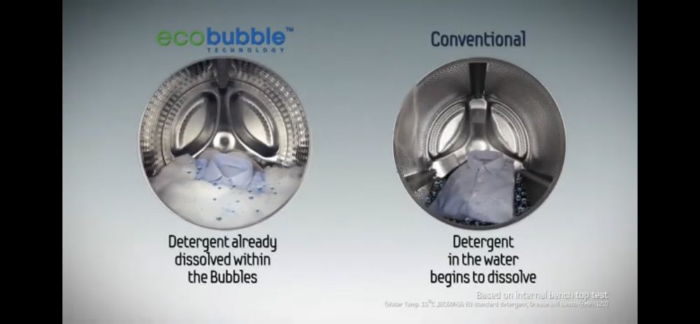

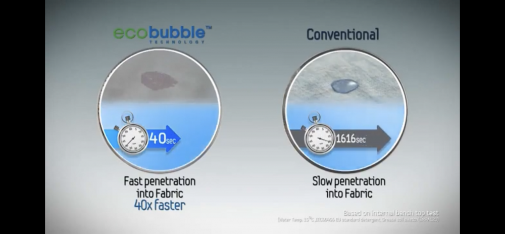

Hi Andy. If you look carefully, there is a "disclaimer" at bottom right, which is designed to be extremely hard to read. I see them all the time on many tv ads.  The technique they use is to use a text colour that is very similar to the background colour.
They then use a drop shadow effect and instead of using a contrasting colour, which is what a drop shaddow needs, they again use virtually the same colour.
The effect is a hardly noticeable text, that just looks blurred and out of focus. Even with a screen capture and zooming right in it's hard to read.
I can just make out that the claim is made using an "internal bench test", and the water temperature's only 15 degrees. Essentially the claim is the the detergent bubbles penetrate the fabric much quicker - but presumably only at 15 degrees.
I can't help thinking that its just a technically true claim that in real world makes little difference. Otherwise, their washing machines would wash much better than the rest and much quicker. I'm not in a position to say if that is the case or not but it does all seem a bit fanciful and gimmicky.

Having said all that, if Samsung are only claiming this system is much faster when washing at low temperatures - especially 20 degrees then fair enough.
