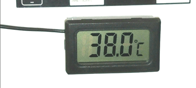

here was my little test set up using a digital thermometer :
38'c maximum temperature with 54 minutes left to finish cycle (wash including rinses & spin) - 5 minutes from reaching 38'c the drum emptied and then started going into its rinse cycle!!
I suppose our only saving grace these days (seeing as it seems most of the time you do your washing is in cold/lukewarm water until it reaches set  temperature of the wash cycle ) is that with the advancement of science etc a load of soap powders and liquids these days say (claim) on the front of the packaging that they get to work even at low temperatures (as low as 30'c or 15'c) bear in mind in the winter as its very cold outside that your mains water can be around 8'c and lower entering your washing machine drum, so it takes a bit of time to actually heat up to 15'c or 30'c.

Hi Andy, my understanding is that modern detergents are designed to work most effectively when cold water is slowly heated to 40 degrees. This is definitely true for biological detergents, but may also be true for normal detergent. By the time the temperature reached 40 degrees, the laundry is clean.
This is why it's a bad idea to artificially add hot water to the wash cycle, as it will just cause the wash section to finish much earlier – before the laundry is properly clean.
