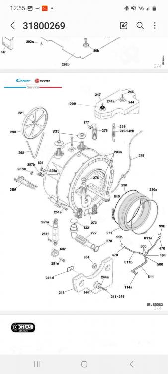

I have attached a parts diagram where the heater is located, I cannot see any other locations where a TOC is present for the wash cycle bar the thermostat.
Any ideas if there is/where to find a TOC for the wash cycle?
We have put the machine on a white 90C wash to see if we can feel any warmth through the glass, I assume at that high temperature we should still be able to feel some heat coming through if it was working properly. Just like we can for the dry cycle. Thanks for your reply.
Heater for wash cycle is part 286 and has the thermostat built into the frame of it. Which I assume is part 287/287B model dependant. There is nothing else in that area that I can see that is near the heater.

Hi Graham, no, I said it's part of the heating element and if it blows the heater will be open circuit.
Ah yes I get what you mean. It is not reading open circuit so can only assume it is functional. The hot wash is not heating up so I can only assume now it is a wiring fault/control board fault. I will check the continuity of wires to the board and then point the finger at the PCB. May be time to replace the unit if that is the case.
