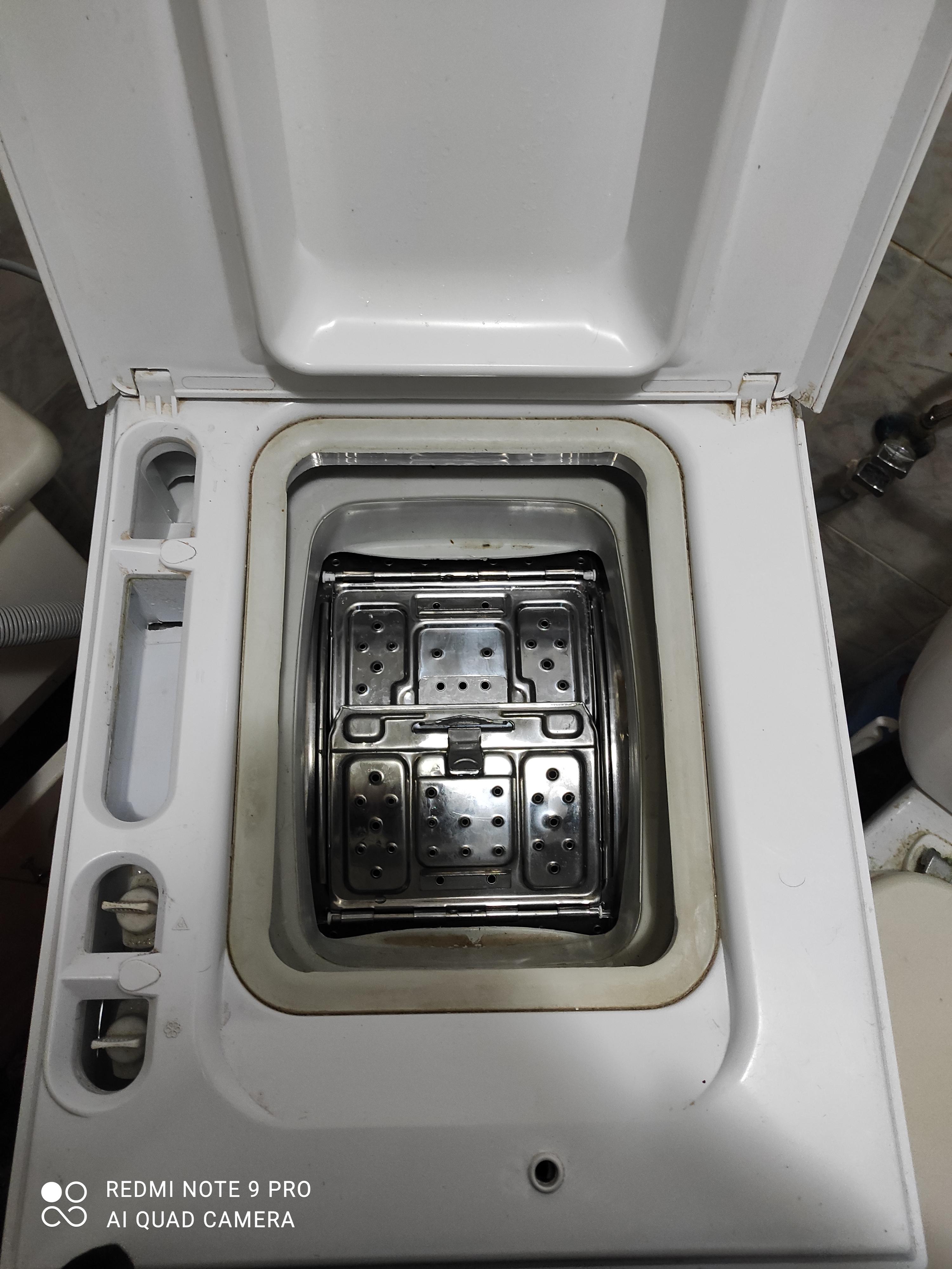

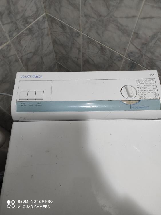

Looking at your 2nd photo, I can't see how the washing machine could tell that the inner drum is closed. The top loading washing machine I worked on before redesigned the inner drum so that when it was opened, 2 flaps stick out and physically prevent the top lid from being closed. This is an extremely simple method.
I get the impression that your drum does the same from looking at the 2nd photo? But surely if your washing machine did that, it would have been impossible to have started it because you wouldn't have been able to close the top lid.
The hole in the top at around the 6 o'clock position looks like something that houses a microswitch underneath. So when you close the outer lid, a peg pushes into that hole and operates a microswitch. If the washing machine was run with the outer lid open (if that's actually possible with this one), then I would suspect that everything would work except that the drum would not revolve because it is dangerous.
So therefore if what I'm saying is correct, I would suspect that when you are closing the outer lid it is no longer operating the microswitch underneath. If my speculation is a long way off then that's all I've got unless you have further information that sparks off other thoughts.
