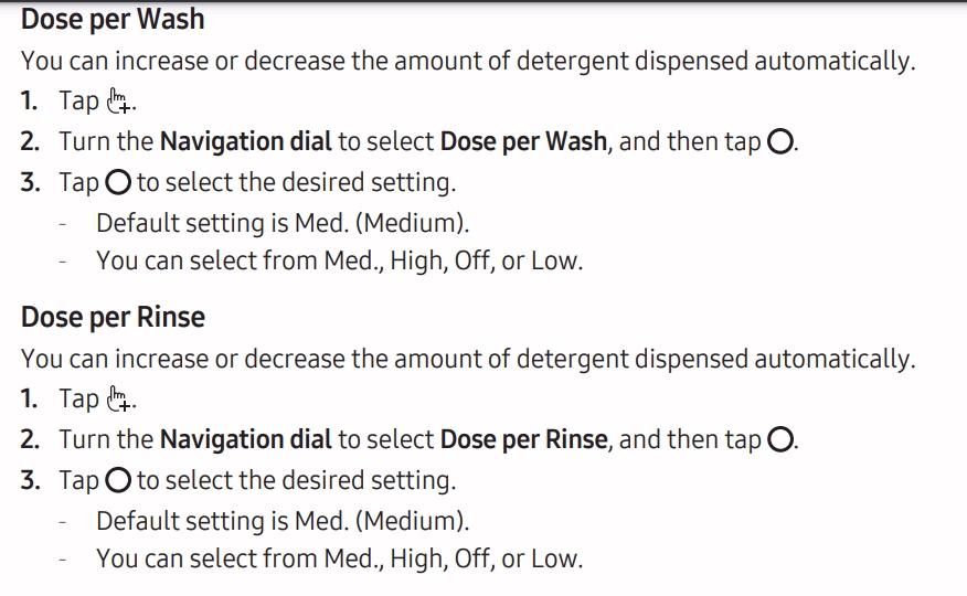

10 hours ago, Whitegoodshelp (Andy) said:
 Regarding the setting for auto dosage that you described in detail on your review, does it say anything in the manual about exactly why and how you should set that setting properly? For example, is it related to water hardness, with high setting for hard water and low setting for soft water?
I feel if not explained properly in the manual, that many people will just automatically choose low
here is screen shot of manual - no indication really of why they give you the options of dose per wash and dose per rinse and just say normal is Medium to select .... thats what we have done with ours, left it on medium for all washes
The most sensible option, I'd say.
Yes it doesn't make sense because the options to adjust the amounts of detergent are labelled, dose per wash, and dose per rinse. But of course there should never be any detergent added during rinse! I wonder if it is referring to fabric softener and is just a terrible translation.
