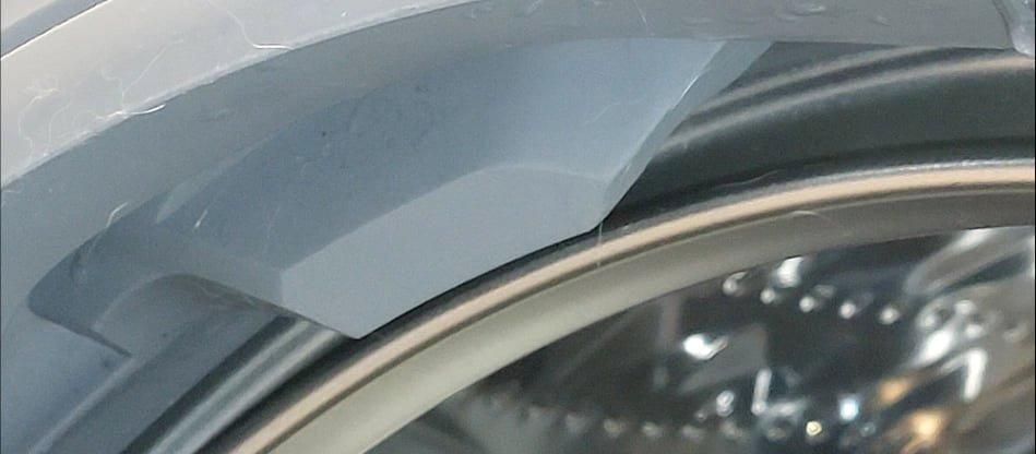

Now that sounds pretty noisy Andy, what have you got in there? What is that thumping noise? It seems to me that it is only half-heartedly trying to spin, or just energising spin for a second. Possibly because the load seems a little bit unbalanced, and it's not confident enough to go into full spin?
I did amplify the sound through audacity because the phone's camcorder did not pick up the whirring hardly at all - but I wanted to relay that noise.
The thumping is the clothes as they brush past the little lip top of the door gasket , because the washing machine 'weighs' the clothes dry ... if they were wet, or rather when they are wet you dont really hear them rubbing past that lip. I am presuming the lip is there to stop garments from getting caught between the door gasket and the door glass bowl. So if something did get stuck between the rubber door gasket and the glass door the lip would just push the clothes into the drum instead of getting stuck. I think thats what the lip on the rubber door gasket is there for anyway?
And in fairness on that video I had 'overloaded' the drum as well that cycle before recording it so thats also a reason why it knocked on that lip. So if I load the drum correctly you dont get that thump/knock ... but the whirr noise is the one I am surprised about especially with an invertor motor - but cannot yet make out if the whirr is from the motor itself or the electronics of the motor driver board sending the noise down through the motor.

It's very difficult to overload such a big drum Andy. If the laundry was wet, they'd have possibly settled down a bit more.
