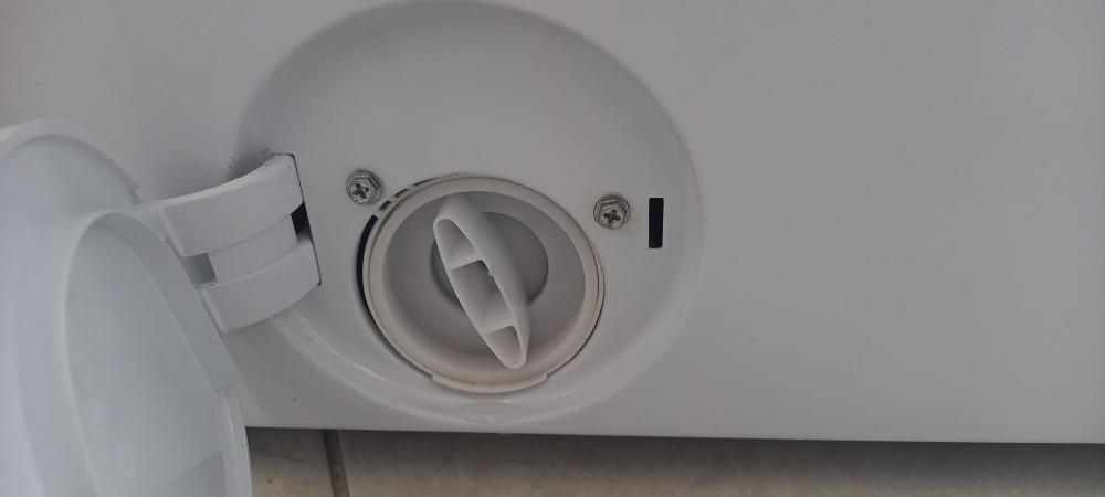

Hi, I have a small problem hopefully you can help :)
I have a Candy ROW4956DWMCE-80 (it's a washer dryer so I hope ok on this forum!)
I thought the app would tell me when to clean the filter but after almost a year (of 1/2 washes a week) I decided it was overdue.
But it won't open. It will only turn about a quarter/third of the way whereas the video on YouTube of a Candy RapidO filter clean shows it turns a couple of full circles to open fully.
So I guess it's jammed/something is stuck in it. I've tried rocking the machine a bit gently to see if that dislodged it  but no luck so far.
Is there any way into it myself? It's not obvious what those two screws in the picture are doing. The back of the machine is all sealed up so I wouldn't open it without a clear idea of what to do. The manuals are (quite reasonably) aimed at normal use/maintenance.
Appreciate any thoughts! I did check the FAQ and I don't really know what the below means and how I could retrieve the obstruction- is this something reasonable to do myself or should I get someone in? Is it actually a problem if the washing machine is functioning well?

I’ve had cases where the filter appeared to be jammed and wouldn’t come out. It proved to be an under wire from a bra or another obstruction that was entangled in it preventing it from unscrewing. I had to remove the main sump hose leading into the pump and retrieve the obstruction from there, which then allowed me to get the filter out.

Hi. If it has something stuck inside it can jam the filter and stop it coming off, though it’s usually something long like an underwire from a bra.
In such a case there is usually some resistance when trying to undo the pump filter rather than it stop solid. It’s unusual for something more substantial to be in there without it having caused a lot of noise previously.
If you are sure the filter should unscrew a lot more (what does it say in the instruction manual?) then it must be jammed. If it were me I would get some strong pliers (not narrow nosed) and carefully try to exert a bit more pressure. You do of course risk breaking it. But if it won’t come out it may prove necessary.
I have an article on pump filters which contains advice about what to do if one is jammed but it involves taking the sump hose off.
If you aren’t having any problems, and don’t have to take out the pump filter, there’s a school of thought that says just leave it alone. But there’s another school of thought that says sooner or later you may well need to take it off, so it needs sorting.

The potential problem to consider, is if in the future the washing machine breaks down full of water because the pump has failed, or because the pump filter is blocked.
In this situation you will be in trouble because you will have to try and get the washer out, which is hard when full of water and very heavy, and you can’t open the door. Then you will have to drain the washing machine before trying to get the pump filter off.
So although there’s no panic, my advice would be to try and get it off when in the right mood. Alternatively you can hope it doesn’t cause a problem, which is possible of course.

Here's a quick video - I have tried pulling it out from this position  but if I pull hard enough the entire washing machine comes towards me. It starts horizontal and I manage to turn it a bit more than a quarter anti clockwise. You can hopefully see in that position it's not letting me turn it further than this (I've tried harder than this but for the purpose of the video I was trying to be short)
Thanks for the video. Yes it looks like it ought to turn further. Good chance something is in there.

Thanks again for all your advice before. I wanted to let you know I managed to get it sorted!
I wasn't able to get the washing machine onto it's side by myself (too heavy! Wondering how I ever managed to install it by myself...) so while waiting for a relative to come help  me out with it, I have been trying to get the filter off every now and then. And it finally worked! It turned a bit more than usual and with some gentle back and forth it eventually opened all the way - as well as the usual fluff there were three or four tiny bits of cotton towel (two inch circles).  Which explains why they were stuck before but also possible to thankfully squeeze out of the way this time - they were wet so more flexible! Glad it didn't turn out to be a bra wire or something more damaging. It does also explain where a damp smell in my kitchen was coming from- the cotton was retaining water. I'd checked for leaks under the sink tonnes of times, but it was this!! This is maybe all gross explanation but I'm so relieved to have found it.
And now I'll add "empty filter" to my once a month maintenance list so I don't let it build up to that state ever again!
