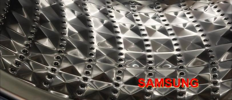

As a guide to see how large the holes were in the drum of the Hotpoint washer i got my drill bits out to see which drill bit fitted the diameter exactly in the holes in the drum in the Hotpoint Washer .
Here are the holes in the Hotpoint washing machine drum:
Then I put the same drill bit into the holes of the Samsung Washing machine holes in the drum and it would not fit , so the holes are definitely (not much) but smaller than the holes of the Hotpoint washing machine Drum (cannot be seen properly in the pic):

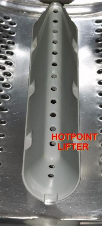

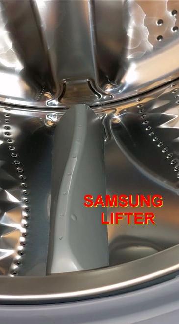

Other observance - the holes in the lifter of the Samsung are like 'pinholes'
Compared to the holes in the lifters of the Hotpoint which are a lot larger, about the same dimension of the holes in the drum itself:
So there you go, I would be fascinated to see what others think. Would the larger holes in the Hotpoint help with extracting the water out of the garments better by centrifugal force better than the Samsung Washing machine drum with smaller holes - or has it no bearing whatsoever at all on the performance of the spin?
Hello Andy. What size drum capacity were the two washing machines? Drum capacity can affect spin efficiency, with the larger drum being able to exert more centrifugal force.
However, it seems that it's not an exact science and definitely all spin speeds on different washing machines aren't necessarily the same. If you look at the table I have on this article, how drum capacity can affect spin efficiency in washing machines, there are some strange results. Some washing machines have the exact same spin speed and the same size drum and the exact same spin efficiency rating. But some washing machines have a larger drum and the same spin efficiency rating. But most of the drums with larger drum capacity have a higher spin efficiency rating.
I can understand your interest in the differing drum designs, which are a natural concern when you observe the differences in spin efficiency and the differences in the drum design and the holes. If it was just down to something as simple as size of the holes though, I'm pretty sure that all washing machine drums would have the exact same size of holes and the exact same number.
Water is expressed from the clothes by the centrifugal force of them being pressed into the drum during spin. Theoretically, if there were no holes in the drum at all you should get the exact same amount of water extracted from them. It's just that obviously we need holes for the water to drain into the outer tub and get pumped out.
Another issue is that some washing machines with the exact same top spin speed will spin at that top spin speed for less, or longer than others. I remember the old Hoover fast spinning washing machines only used to spin at the top spin speed for about 30 seconds, and even then only if it had decided that the load was optimally balanced.
A lot of washing machines will reduce or even miss out the very top spin speed if the load isn't nicely balanced, and if you have a larger capacity drum this is more likely to happen as it is common for large capacity drums in washing machines to be regularly under loaded. This is due to the fact that the average wash load for the average household is way lower than 7, 8 and 9 kg. Large capacity washing machine drums are ideally meant to facilitate washing twice as much laundry at a time, and therefore saving on wear and tear, water, detergent, and electricity. But most people buy them and carry on washing the same loads as they did before, which is pretty pointless.
