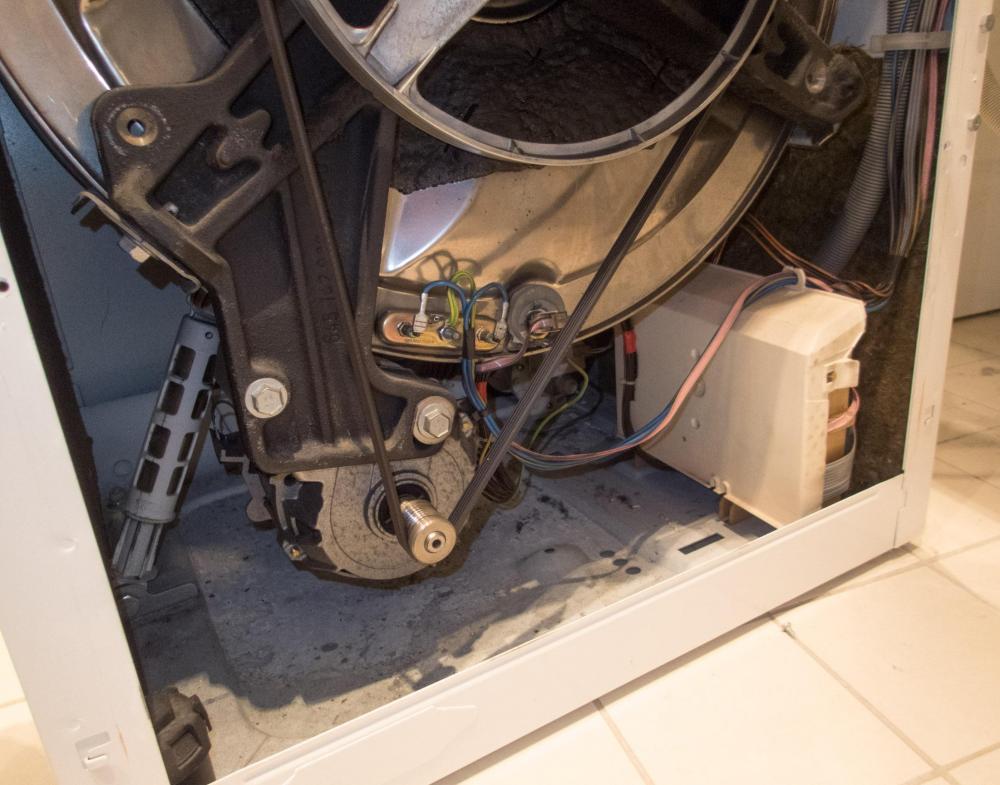

I believe the shock absorbers in my AEG Öko Lavamat 74600 are worn out and need to be replaced as the drum runs unevenly even with light loads. The springs holding the drum from the top both look OK, the drum spins evenly without any load so can't see any other reason for this than the shock absorbers needing replacement. Is there anything else I should look into before ordering new ones?
I've removed the rear metal panel, but it looks like a very tight fit to replace the shock absorbers (there appears to be two from what I can see although I hear some machines use 3 or 4) from there. Does anyone know if it's possible to remove the side panels, or another way to get better access to them? I haven't been able to find any repair manual for this unit.

It doesn't seem like the ball-bearings are gone either, so I'd like to take a look at the shock absorbers. But I'm having trouble figuring out how to access them. According to some Youtube videos it might be possible just to open up the front -what do you think?
Is it possible to open the side "walls" of these washing machines?

All valid arguments there. I suppose there's only one way to find out -remove the shock absorbers and see if they work as intended by trying to pull/push them with my arms. I would expect a fair bit of resistance if they're OK and a more lose action if they're worn out.
How do you suggest I get to the shock absorbers when simply removing the rear panel doesn't seem to do it?
Just bounce the drum around from the top. You can push it down and from side to side to assess the dampers without taking them off. If they are very loose and the drum doesn't bounce back maybe they need replacing but it should be obvious if they are knackered. Normally just lay machine down and get to it from back and underneath. Some fronts come off but not all.
Aha! I can't remember ever having gotten to it from underneath. Is the bottom a metal panel which can be unscrewed and removed?

If you lay it on its front or side you should get access from underneath. Just make sure you totally drain all water first or water can run out into parts. There's usually a mug-full or more of water in the machine even after umping out. Best way is to pump it out and then put a big sheet or bath towel in front of pump filer and remove filer to let it just drain out.
Thanks for all the advice! There was no access from underneath, but the trick was to tilt it slightly to one side (so the motor (hanging fromt its springs) shifted to one side, gaining access to one of the hard-to-reach shock absorbers.
Workspace was quite tight but removing the front panel was essential (in addition to the rear panel) so as to be able to unscrew the large shock-absorber mounting screws. I also had to had to remove the pump and disconnect a few rubber hoses to gain access.
The two shock absorbers were both completely blown! No resistance at all, so it was definitely time for a replacement.
Now the washing machine is running along like brand new, and will hopefully last for a while longer!

No, I couldn't tell. They looked fine from the outside.
It wasn't until I removed the mounting screws to remove them that I noticed there was absolutely nothing to hold the upper and lower sections of them together. It seemed like whatever was inside to dampen them had totally disintegrated! Basically, if I grabbed the upper part the lower part would fall off!
