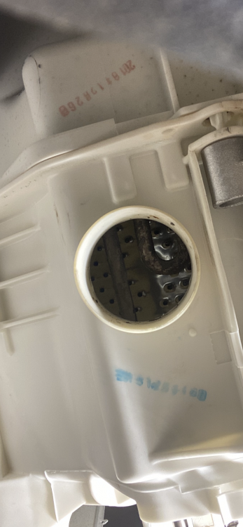

Are you sure it’s leaking from the lines and not leaking from higher up and just dripping off there? Leaks from the drum are almost exclusively caused by damage (cracks or holes) caused by metal objects left in pockets such as coins.
6 minutes ago, Eileen said:
There was two pound coins found

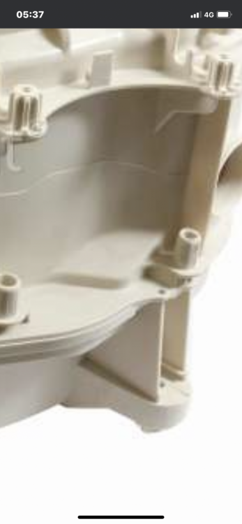

That would explain damage to the outer drum and leak. But there’s no way a coin could cause a crack so perfectly straight.

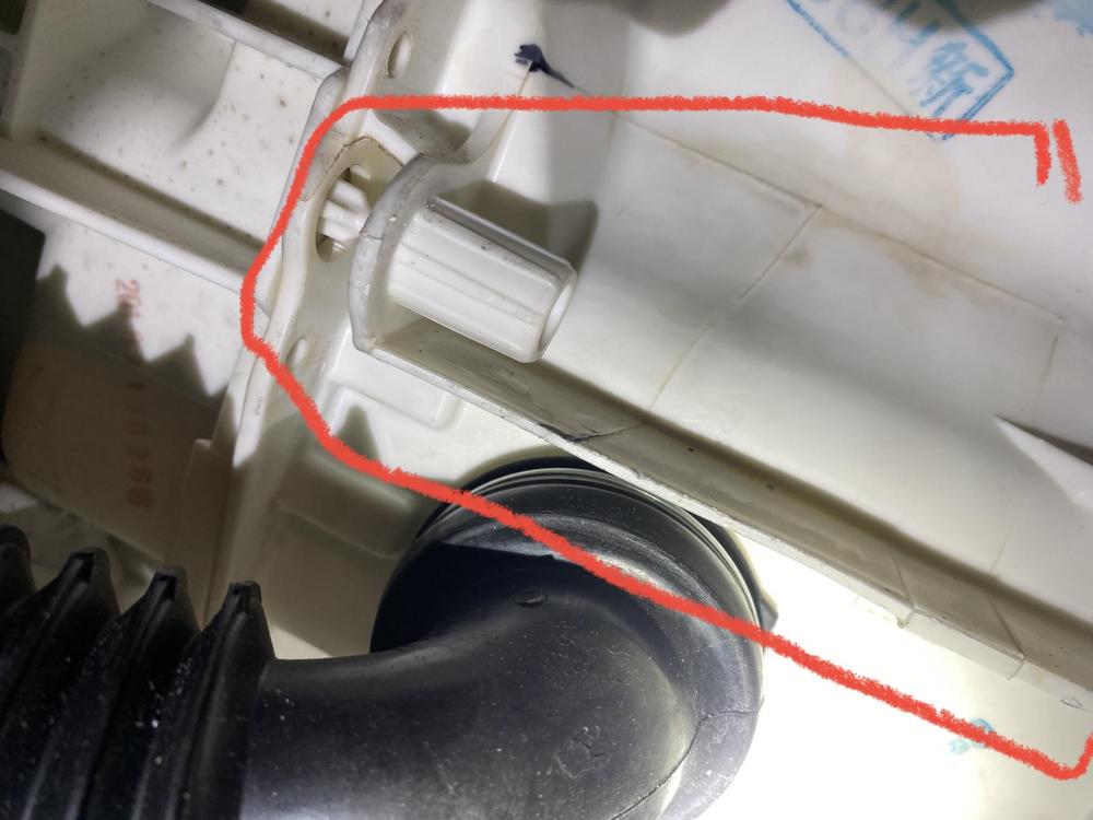

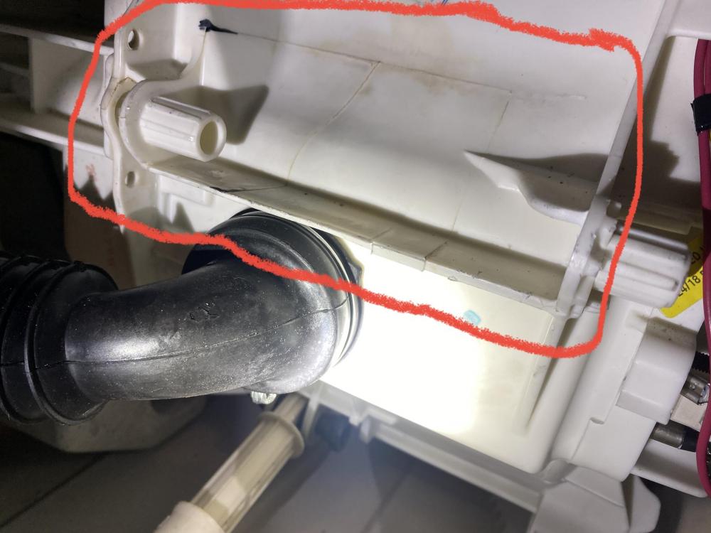

There was two pound coins found after I’d checked the filter the first time  and after cleaning all the hoses out and no problem I’m looking for cracks which looked like there was one there but had to remove the motor to check properly and to me it looks like it’s already been glued together and comparing with a new drum it’s not same
Hi. If the tub is cracked it would need replacing. Small cracks might be able to be repaired as described in my article here how to repair cracked plastic drum on washing machine

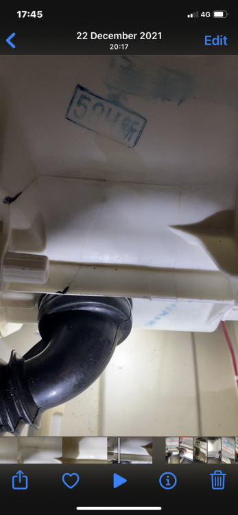

If a coin damages a washing machine outer drum it is often high up or even at the front. I've never seen a crack that was in  perfectly and long straight line though. Often the coin punches a hole. I can't see any cracks in your photos, only manufacturing lines.
Is it top left just above the red numbers?
Thank you for your help Andy i didn’t have a soldering iron so I used a heat gun to heat a small flat head screwdriver and smeared plastic from one side to other then I put a layer of sticks all adhesive sealer on top and tried it out today and no drips so thank you so much x
Excellent. As long as it was only a hairline crack that didn't form a full circle it should be ok as long as there's no more coins! :)
