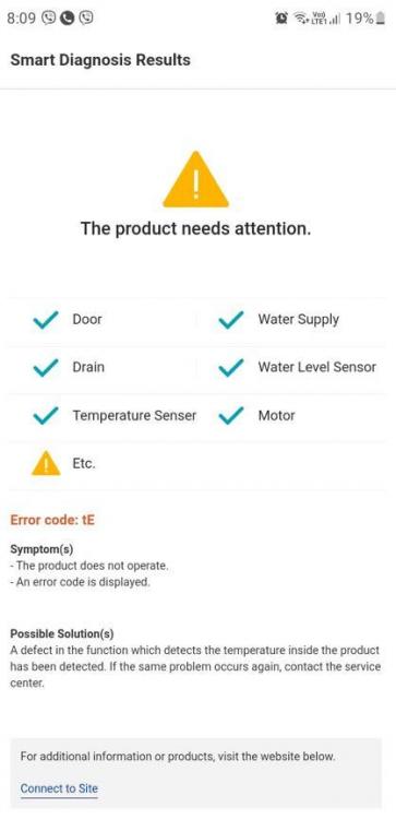

Appreciate your support. I have attached a video and an error diagnosed by the Application.

[img=https://ibb.co/0BVk9K5]Washer diagnosis error message[/img]

Hello there. Unfortunately error codes are not 100% reliable, but at the end of the day we have to do trust what they say until it is proven to be incorrect, which is rare but it can happen. "A defect in the function which detects the temperature inside the product" could well be a thermistor but it could also be something else such as a connection fault somewhere in the thermistor circuit or even potentially a fault inside the PCB. However, with this error code the sensible thing would be to check all of the connections to the thermistor and if nothing is found replace the thermistor.
Only then can you have eliminated the main suspect indicated by the error code.

Thank you so much for your advice, I shall connect with LG local guys here.
