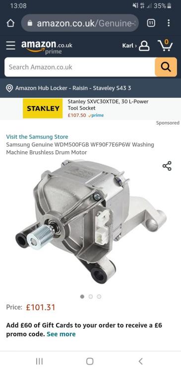

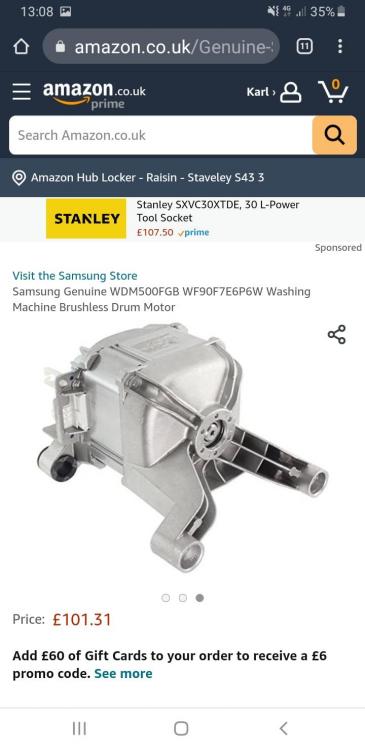

The motor I have is a DC93-00316A brushes one (pictured) and it has no tacho sensor that I can see. Where abouts will it be located?

Sorry it should have been brushless motor.

Hi. Sorry I forgot to mention that brushless motors don’t have tachometer coils. However, the error code says tacho coil error, which goes to show how unhelpful the codes often are.
If a brushless motor is running laboured and struggling with no power then unless you can find a poor connection to it on the motor plug or motor wiring there’s nothing you can do. It could need a new motor or new PCB but they are way to expensive to gamble trying one.
