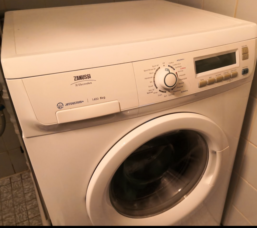

* Machine doesn't fill,  starts program, makes humming sound but does not take any water.
- Water feed seams 0K, usually gives error code if it does not get water, good pressure in water feed hose.
- Spin program works fine.
Mark/Model:

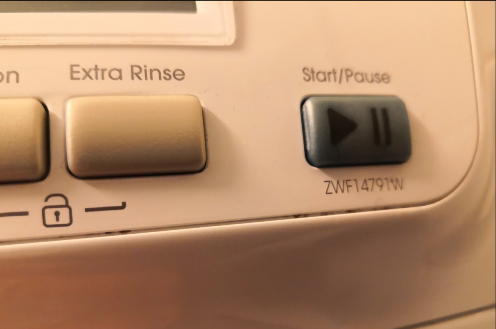

Zanussi ZWF14791W,
Fault Code

image.thumb.png.9bd04d006400daa425cee4d765aa9b97.pngimage.thumb.png.2ae2c309cffc5926d44e94ffa97b4431.png
