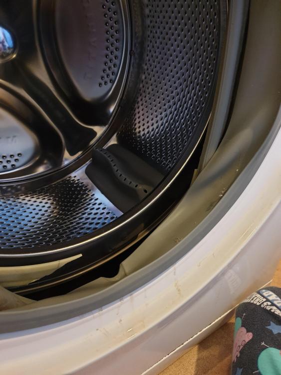

I have a hotpoint aquarius wdal 8640.

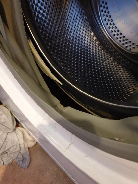

Last night during a drying cycle the machine made an almighty banging noise so I turned it off and discovered some snapped plastic and the seal pulled down. Am I right in thinking the drum has broken?
Many thanks for any input.
That looks terminal if the plastic is the outer drum. Usually caused by something metal left in a pocket that gets into the drum.
Thank you for the reply. Terminal as in the drum could be replaced do you think? Or new washing machine time?
Drums can be £200+ and a massive job to do. Check Ransom Spares to find out the cost of a new outer drum.
