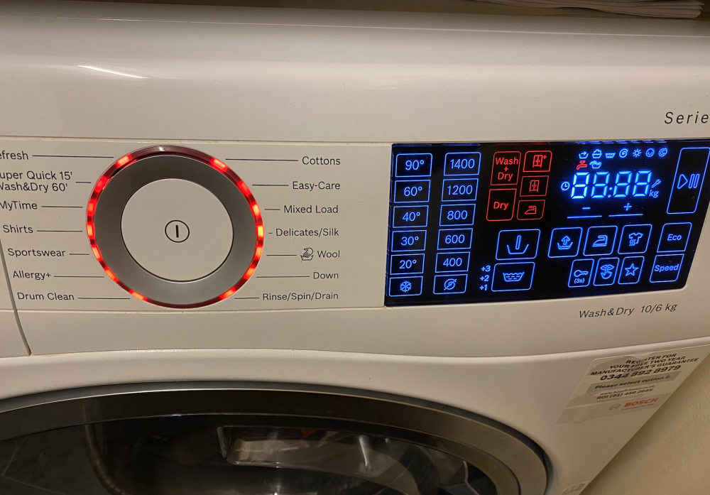

Basically, last year I bought one of the fancy series 6 washer dryers from Bosch. Have been fairly happy with its performance until about two weeks ago when it just wouldn't turn on. I tried turning it on and all the lights around the knob were red and the whole panel was lit up. There was no response when I tried using the panel, it wouldn't even turn off. Had to turn it off on the mains, after turning the mains back on the machine never turned back on again.  Only feedback I'd get from the machine was some clicking, but then nothing would happen.

Anyway didn't think much about it - did a wash yesterday. Was about to do another one today, I pressed the power button and suddenly, once again, the RED RING OF DEATH (how I'm calling it - all lights and the panel on) showed up. Couldn't get rid of it, no reaction at all. Turned the mains on and off and again, no reaction. Seems like I'll have to go to the laundrette again this week...

Hello. It's always extremely frustrating when faults are intermittent. As an engineer I always hated that too. The only thing I can say is that the clicking sounds like some relay that's either not working properly or not being responded to. This is likely to be in the main PCB. The only positive thing I can say is that you now have a video that you can show to the engineer if by any chance it does spring into life when they try it. They will have no option but to witness the symptoms and should be able to act upon it. It may well need a new control board or main PCB.
Please let us know what it turns out to be.
