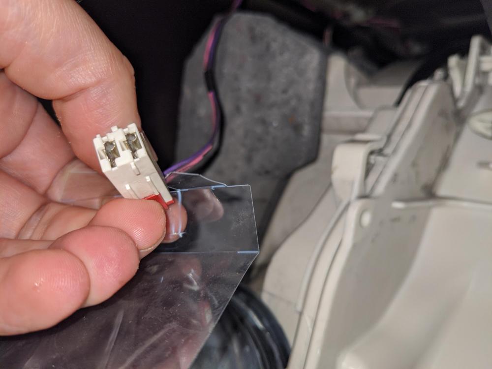

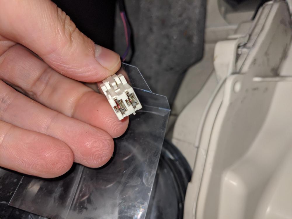

Hi, I wondered if anybody can help me identify a replacement drain pump for this machine as Beko don't stock the genuine part anymore.
I can't find a universal part that seems to match this one
Pics of pump here https://imgur.com/a/IKo8EH3
Hi. The picture won’t help much as most pumps look very similar. Try www.ransomspares.co.uk
Yes you can do that If you are comfortable doing it. Or if the old one has a plastic plug that would be able to be cut in half to make separate connectors that’s another way of doing it.
Ahh that would be tricky then. I was meaning if they were side by side the other way. As long as the wires are long enough you can cut them and fit 13 amp tags. Just make sure they can’t touch and short out. If close you can insulate one of them with insulation tape.
