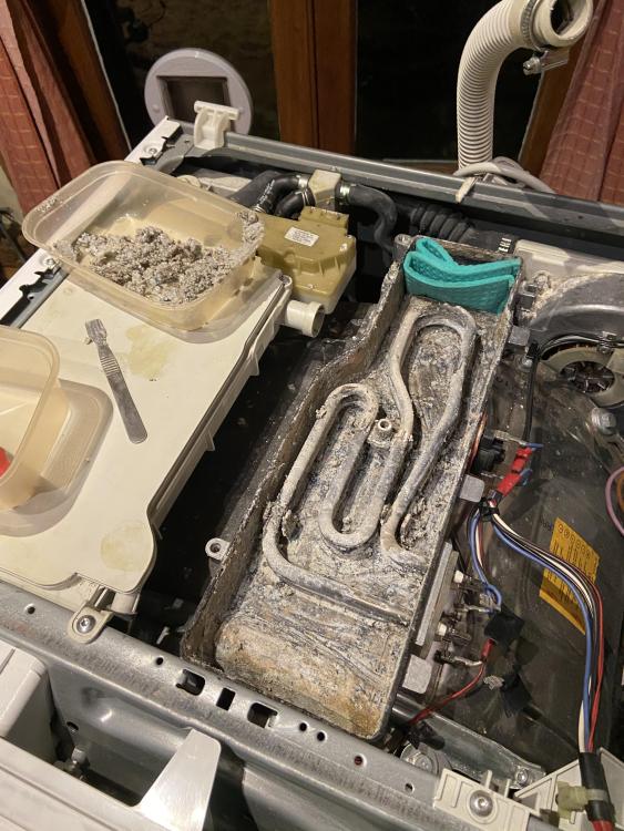

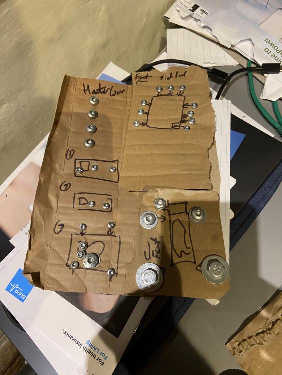

DIYCamp Posted January 5, 2021 Posted January 5, 2021 Jayj, you have spured me on last night to fix my drying issue..... so I took apart the machine and cleaned out all of the dirt/fluff.... here are some photos..... There are a number of videos to open the top of the machine, but once inside, if you open up the silver box this is were the heating elements are. There are three 30torx screws holding this down, and it is also sealed. You will need some heat resistant silicon sealant (say from Halfords) to reseal. Note that it is hinged on the right hand side. You can see all the dirt/soap scum etc inside mine. To open, undo the three torx and then using a long blades flat screwdriver carefully leverage up on the left hand side. I tried to clean it out, but given the amount of dirt it was impossible so I removed it instead.... Note that I put a sponge down the slot at the back.... don’t want to drop anything down into the fan and the bottom of the drum. In the second picture you can see the pipe work that sprays water down into the fan during the de-fluff programme. I have some more pictures but can’t upload them due to size of posts. In the end I took out both the fan and the heater box, cleaned them all, out them back together. It took about 5 hours and I did not cut my arms (must have been lucky). It was actually much more straight forwards than I had read which is why I had been putting it off quite frankly. What I did notice in my washer is that there is a lot of pitting and general corrosion of the aluminium parts. My washer is 11 years old. The house has a salt water softener and it would be difficult/impossible to get unsoftened water to were the washing machine is. I suspect that this is related to the corrosion. I will past some other photos in a second update. Whitegoodshelp 1

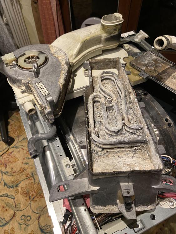

DIYCamp Posted January 5, 2021 Posted January 5, 2021 Here are some more photos.... the first is with both the fan box and the hot air box. They do both come out fairly easily, the fan box just pushes into the back of the drum, but remember to retrieve the rubber, slightly square seal, and reseat properly. In terms of access, if you tilt the machine then the drum moves giving you access to various bolts etc without having to take too much apart. Lastly, I use little pictures and cardboard and push the screws through as I remove them so I know where they go back and in what order. Here are all the screws you need to remove to get to the control panel, front and right hand slide cover off, as well the heater box and fan box out. Thx R Whitegoodshelp 1

Root Admin Whitegoodshelp Posted November 11, 2021 Root Admin Posted November 11, 2021 On 05/01/2021 at 11:22, DIYCamp said: Lastly, I use little pictures and cardboard and push the screws through as I remove them so I know where they go back and in what order. Genius Need a repair or spare parts? Book a Repair | Spares4Appliances WARNING: Read this before attempting any diy repairs. No representations or warranties are made (express or implied) as to the reliability, accuracy or completeness of advice. I can't be held liable for any loss arising directly or indirectly from the use of, or any action taken in reliance on, any information on this website, which is given free of charge and in good faith.

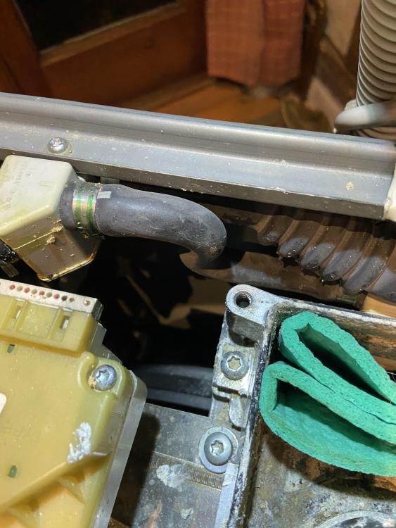

DIYCamp Posted November 11, 2021 Posted November 11, 2021 Without pictures it is hard to know, but I guess the leak will probably be coming from the wide rubber hose that connects to the top of the drum, just inside the door, to the heater box. The drum moves around quite a lot and if the rubber is not seated properly/secured then it can come off. Easy to fix if this is correct. I would suggest you do not use the machine AT ALL, as even when it is just washing you do not want moist air circulating inside the machine. Whitegoodshelp 1
