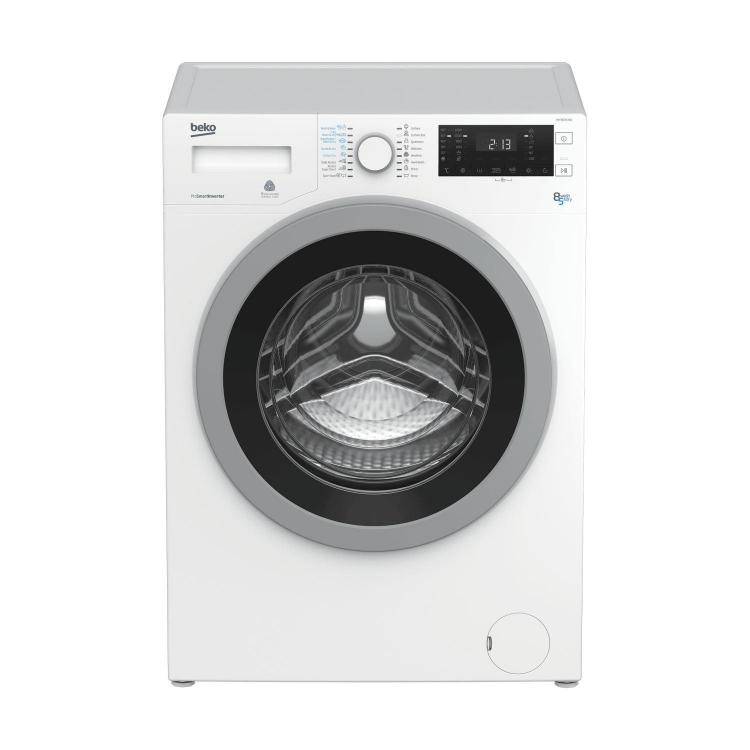

I have an issue with Beko HTV 8633 XS0, this machine only takes water and after few minutes the screen is shutting down.
As long as the machine is off, the water starts to drain !
Please watch the video to see more details:

Could be a faulty water valve but would need checking with a continuity tester. Disconnect washing machine from the mains and then take the wires off the water valve. Put a test meter across the 2 terminals and you should get a reading (high resistance) then waggle to terminals gently to see if it goes open circuit.
