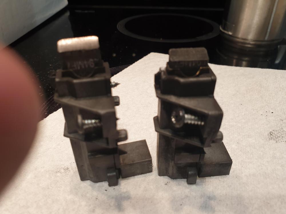

Hi Andy,
Thanks for the help so far, I've got the brushes out purely out of curiosity. There does seem to be uneven wear one being considerably shorter than the other, this one is dull and not showing typical commutator smooth scoring like the other one. Cant be certain that it is or not making full or partial contact. Image attached...hopefully.
Hello. The carbon brush on the right has not been making contact with the commutator and is highly likely to result in the motor not working. Replacing the brushes might get it up and running again though it would depend on the condition of the rest of the motor.
