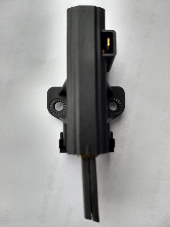

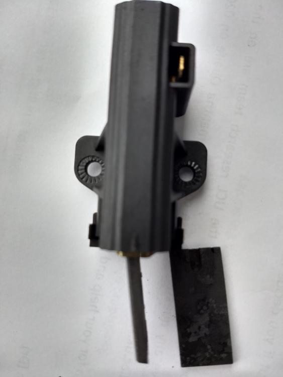

On checking the brushes I noticed 2 things, firstly the connector to one of them was a bit loose and secondly that the motor made an unusual noise when it turned in one direction.
Removing the brushes, one of them had split, seems that the brush is made of 2 pieces of carbon stuck together.
Fitted new brushes and crimped the connector a bit.

Thanks for the update. Hopefully that’s it. I was going to mention a poor connection somewhere but it made nonsense that a poor connection would always hang on until one wash before causing trouble.
