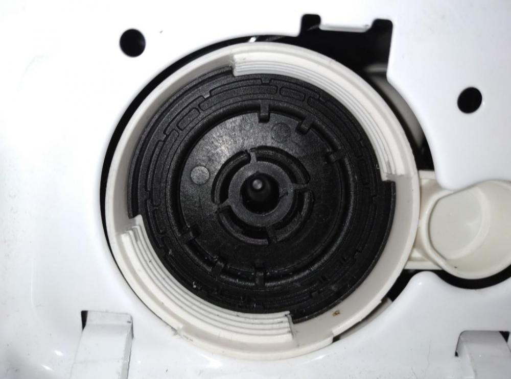

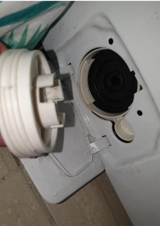

My Hoover dyn8164 D2x washing machine shows E03, I tried to open the drain filter but I only can open outside part  the black inside part can't be removed. I wonder why they design like this .
That black section looks trapped behind the screw thread? If so it's clearly not meant to come out. Maybe it's just a cheap filter designed to trap any obstructions just there. Anything big shouldn't get through the holes into the pump?
