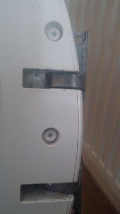

I have the above washing machine which has a broken hinge. I am trying to find out how to remove the broke hinge from the door. Were there is normally a steel screws to hold the door together their are plastic things instead. Could any please tell me how I remove these to get to hinge please?

Some washing machine doors now can’t be taken apart. Check on Ransom Spares to see if you can buy the hinge separately or does it come already fitted on a complete door.
Thanks for the reply. Have drilled  the top of the donut shape not going all the way through to the inner frame and it came apart. Got a new hinge on order for £8. Will let you know how i get on in a couple of days.
