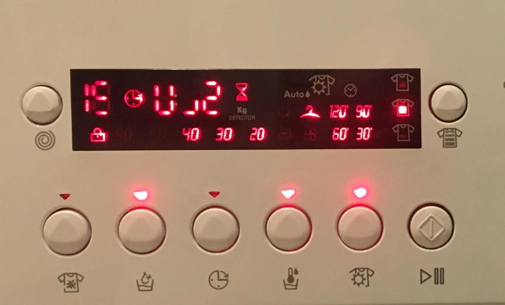

Hi Guys
problem with this washer - it’s empty, drained nothing is blocking the pump but when connected to power near enough all the lights on the front are lit and it’s doing a lot of beeping.
its not looking good - moving the selector isn’t making any difference, pressing and holding buttons like start/pause make the beeping tone change.
any ideas greatly appreciated
Hello there. It's not usually a good sign when all of the lights do that. It's not something that is supposed to happen. Modern washing machines are supposed to indicate specific error codes by displaying the actual code on models that have a display capable of displaying letters and numbers. On models that don't have a display they should indicate by flashing specific option buttons. Unfortunately I don't have Candy error codes at the moment. It might be possible that the 3 lit option lights are indicating a code.
