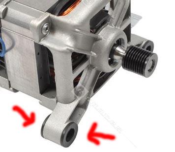

however on stripping the machine down, when I removed the motor, I discovered two of the rubbers that hold the motor to the drum, had disintegrated.  With the motor in place, I couldn't see this,
I suspect that was the problem, hence at slow speeds the motor wasn't rocking but was at faster speeds.

Attached a pic showing the rubber in the motor.  The red arrows point to one washer going through the motor bracket, when I removed the bolts, instead of the rubber going right through, all I had was what looked like two round washers as the inside had totally turned to dust.  So you can look at it without removing the bolts and it looks like the rubbers fine as you still see both sides, it's not until the bolts are removed that you see the middles turned to dust.
Hope that's of some use.
